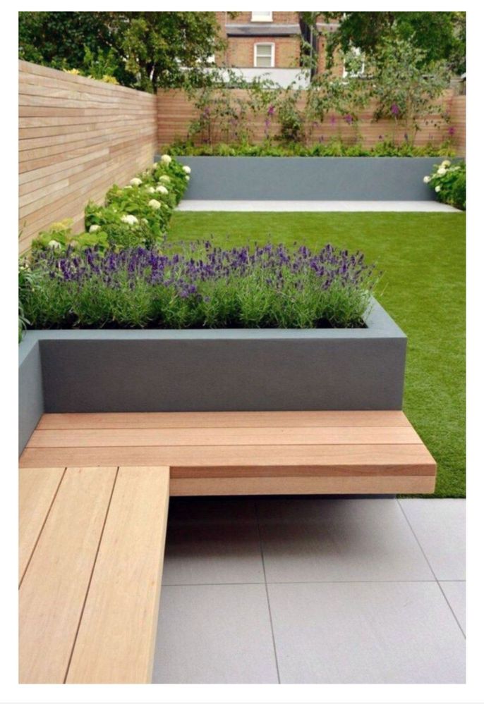

I am willing to make garden bed and sitting area as shown in this picture. But have few questions :-
1) Are these beds made out of concrete and then rendered or it can also be build using timber and then attach rendered board on top of them to give them similar look ?
2) Is the flooring next to turf is concrete ? Garden inspiration

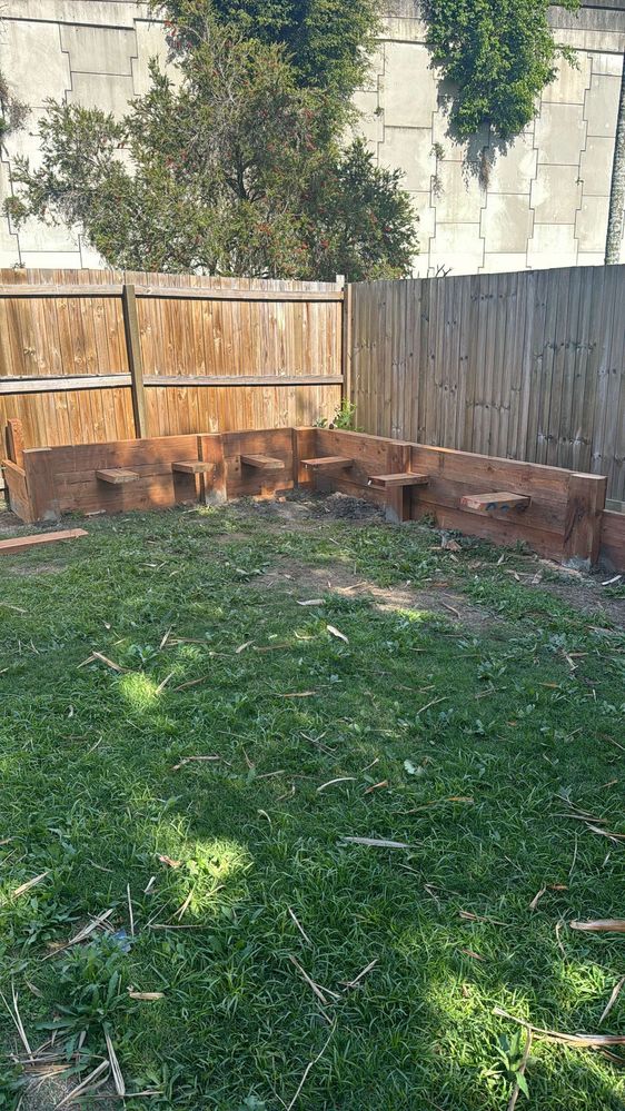

I have done below so far but a long way to go.
I want to use composite decking boards on floating seating bench. How should I approach it ? Should I make a frame and then screw boards on top of that ? Inspiration
Hi @nirmal678,
Great work. Yes, that is what I would suggest. Construct a frame and then screw the decking boards onto it.
Hi @MitchellMc ,
I am looking for a bench like this. Is it a pine decking which is stained ?
I can't find pine decking with this width.
Hi @nirmal678,
That appears to be some kind of hardwood which is at least 35mm thick. Decking typically goes up to 19mm thick. I'd recommend speaking with a Special Orders team member at your closest store to see what might be available from the suppliers in your area. We can order a range of Hardwood that would look amazing for your project. Something like this 190 x 35mm 1.8m Outdoor Framing F27 Hardwood KD Solid would look amazing.
Thank you @MitchellMc , I checked with the store and it seems it will be way over my budget so I settled with this. One last thing which I am not able to figure out is the stain on this decking pine ??
Hi @nirmal678,
Once again, that appears to be some kind of hardwood, not Pine. It wouldn't really be possible to use decking Pine and stain it to resemble such a colour. I recommend you visit your local store's paints department to check out the timber samples on display with stains on them. This will give you a much better idea of what can be achieved.
The other option might be to use Tasmanian Oak, which is much closer to that colour. However, it's not as durable as hardwoods and must be coated to prevent deterioration in the weather.
