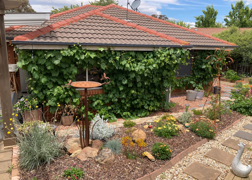

The photo I have attached below is an ornamental grape vine and trellis project I did on the western facing brick wall of my house. I designed it as a solution to keep the sun off the brick which has reduced the heat inside the house tremendously. The bricks are no longer a heat sink and most importantly when I need the heat in winter, the vine loses its leaves so a win on both counts, not to mention how good it looks. This vine is 4 years old and grows at a very rapid rate, it provided shade over the whole wall in 2 years. It is so rapid that the vine grows about a foot a day in ideal conditions. This is a single plant that is planted beneath the window on the left. I now find myself training it to the front of the house and will continue to do so as long as it keeps wanting to grow.

Ornamental Grape shading the West Wall

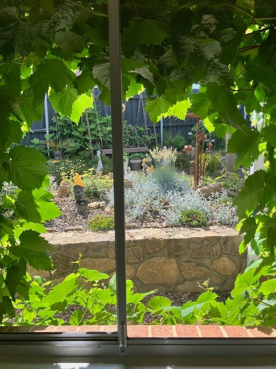

Have added a photo below that shows another benefit of the Ornamental Grape, it frames my dining window when looking out into the backyard. Such a treat especially when the small birds hop through the vine looking for caterpillars.
Dining Window Framed

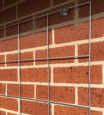

For the wall installation I drilled 7mm holes in the brick using a masonry drill bit. Inside this i placed 7x35 Ramset wall plugs. I then screwed Mesh Accessory Panel clips into the wall plugs and placed panels of Jacks Grip and Grow along the brick wall. This pic shows a close up of the panel clip holding the trellis. I used 6 of these clips per trellis but this is likely more than necessary.

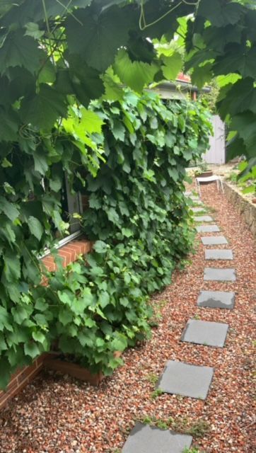

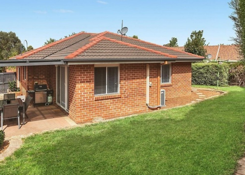

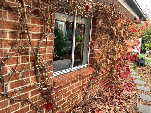

How many plants to use - The following pics are one plant show before and after with another pic showing how it looks in winter.
It is planted beneath the window on the left. I am now guiding it around to the front of the house as I like the look.
