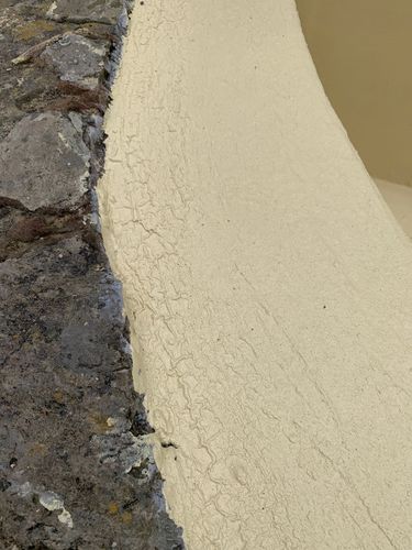

I have had the same problem, but also used two coats of the Crommelin
damp stop on the concrete prior as instructed and allowed 7 days to cure before putting on the pond sealer. When the damp seal had cured, there was some strange yellow discolouration along some areas along edges, which are now the same areas where the pond sealer has bubbled after some light rain about 4 days into the cure. (The remainder of the coat has survived the rain well and I have sponged off all the standing water.) Will this eventually dry and seal or do I need to remove and repaint these areas? Why didn’t the damp stop work?

Welcome to the Bunnings Workshop community, @davidg2. It's fantastic to have you join us, and many thanks for your question about sealing a pond.
Were any products applied to the pond before adding the Dampstop? If there was a previous coating, the yellowing might have indicated a compatibility issue. Also, Pondsealer must not be applied when temperatures are outside 10 - 30 degrees Celsius. I would suspect that nighttime temperatures in many locations would be dipping below 10 degrees Celsius.
The bubbling indicates a moisture issue. So, the amount of rain you received might have been the problem. At this stage, it is just a waiting game, and I'd recommend you shield the area to prevent any more rain from contacting the product. Given the various issues that could have caused this, I'd recommend you discuss your application process and issue with the Crommelins technical team on Ph: 1800 655 711.

Many thanks Mitchell. Thanks for the advice. The Crommeliin damp stop was applied to new concrete so the only thing I can think of is the porous sandstone abutting the concrete. A little concerned now about the lower night temperatures during curing, but I guess it will be a waiting game as you suggested for it to fully cure. Just one final question, when will I know it is fully cured if I can’t count on it being 7 days?
Re: Crommelin pond sealer taking long time to cure
The surface not being tacky is a good sign of a successful curing @davidg2. I'd then wait a few more days after that.
