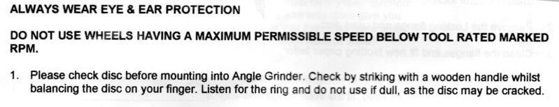

Anyone ever done this?
I'm tone deaf - this is from a 9" grinder/cutter manual from 1999.
I can't imagine Bunnings staff approving of me tapping their discs with a wooden mallet.
Thing of the past with better manufacturing standards?
Cheers.
Re: How to select safe abrasive cutting discs?
There is no need to tap the discs constructed with current technology @Noyade

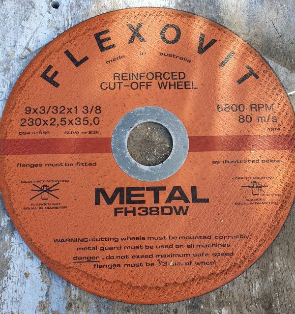

The background is the blade style below. 'Discovered' them recently - 230mm diameter with a 35mm arbor.
I'm thinking 40 years old?
They do not 'ring' - 😁
Cheers.
That watermark alone would be a reason to dispose of them, @Noyade. They are much too old for my liking; I'd get rid of them to ensure you don't mistake them for new blades.
