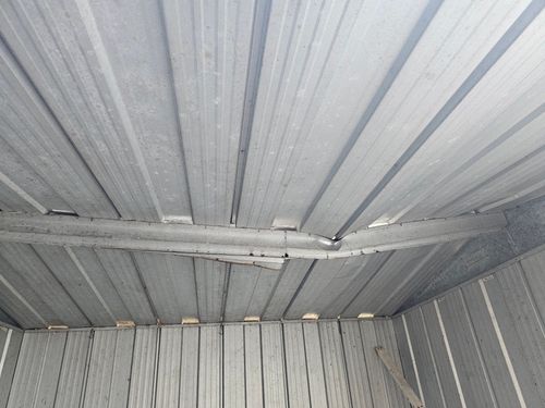

I have a broken shed roof and I wanted to know how I go about replacing the roof along with what tools I would need.
The damage was due to a tree leaning on the shed roof which has now been removed.
I did try looking on the Bunnings website for the materials (that I think I need) but could only find the sheets and the channel. I was unable to find a beam for the roof. My current shed is around 2x2.
Thank you!

Is the shed securely mounted to concrete?
I was thinking of a piece of timber cut to fit the height including a jack.
And seeing if jacking slowly (that sounds bad) reverses the bow. If so, then we need to reinforce that beam. Hard to tell on my monitor - is that beam a light "C" section - seen in fencing?

Hi @Malak,
I haven't heard of anyone replacing roof sheeting or components on a shed, as they are typically designed specifically by the manufacturer. If this was a recently purchased shed, then there is a possibility of obtaining replacement parts from the supplier. Using generic roof sheeting might work, but it's unlikely to suit the trim pieces for the shed or fit correctly.
I like @Noyade's thoughts, and if the roof sheets are in reasonable condition and can be returned to shape, then you'd only need to replace the roof beam. Perhaps it could be massaged back into shape, but that would be easiest if you removed it first.
Thank you both for your assistance.
The shed is mounted on pavers.
From what I can see it looks like it is only the beam that is out of shape or at worst a tiny bit of the roof sheeting. The beam looks similar to the fence ones from what I can see.
Would it be possible to use a heat gun to get the beam back into place?
Hello @Malak
Since there is nothing leaning on the roof now, I propose disassembling your roof so that you can gain access to the steel support that is bent. Once you've removed it, you can hammer it back into shape and have it close to its original shape.
You can then re-assemble the support along with the shed roof. This would be the best way to get your shed roof back into shape. It will require a fair bit of effort on your part, but the rewards of the repair will be worth it as your shed will no longer look out of shape. I'm sorry but a heat gun will not work on the bent steal.
