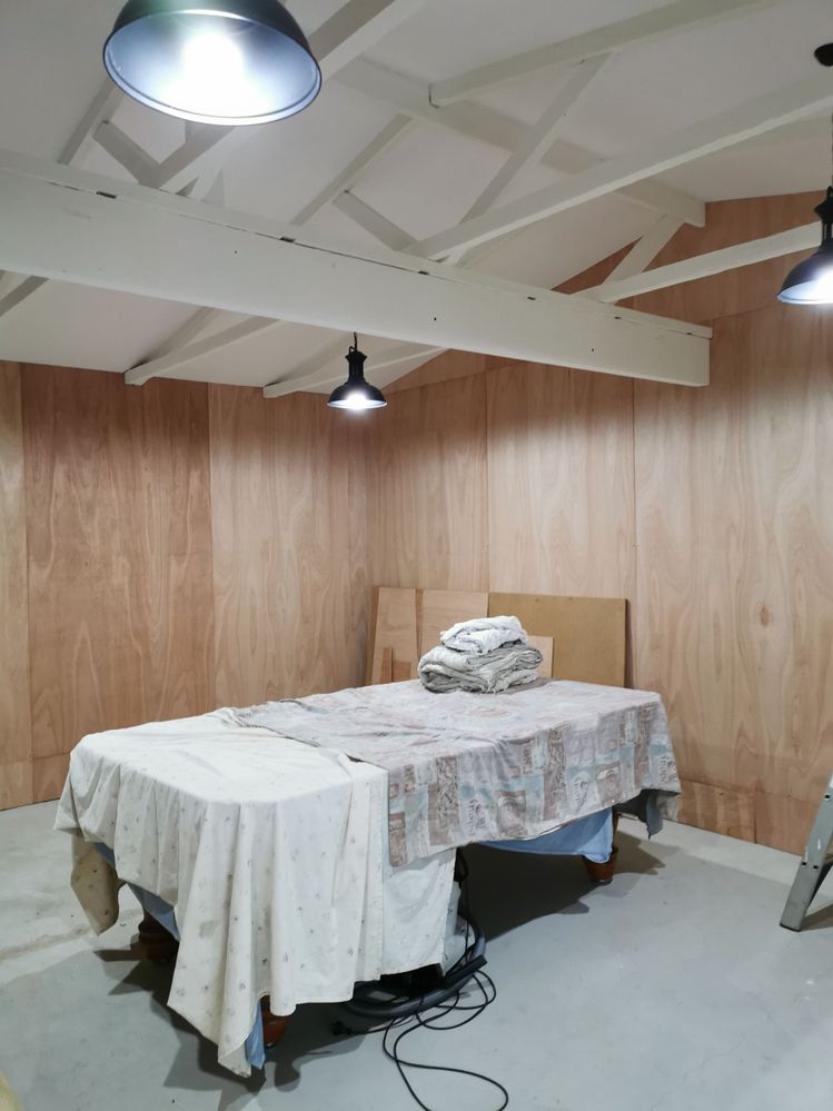

I have atatched a picture of my old shed that we did the same thing to , so you can see what it looks like

Great thank you looks like I have my next job lined up
