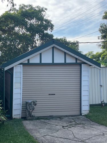

I have an old garage that I want to convert to a music room with lots of equipment. It has hardiplank on the outside and I plan to add acoustic insulation it and then add thick soundchek plasterboard for sound proofing.

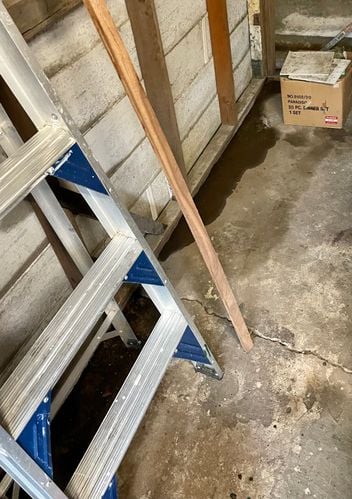

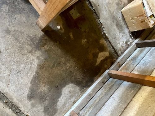

My problem is that some water gets in at the bottom of the walls in heavy rain and I wanted to make sure this was fixed before starting work on the room.

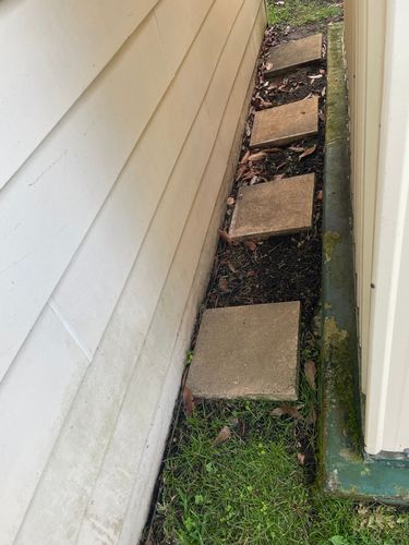

On the advice for a local plumbing store I installed a down pipe and a stormwater pit which goes to a pit of blue metal…but this overflows in heavy rain. (please see pics)

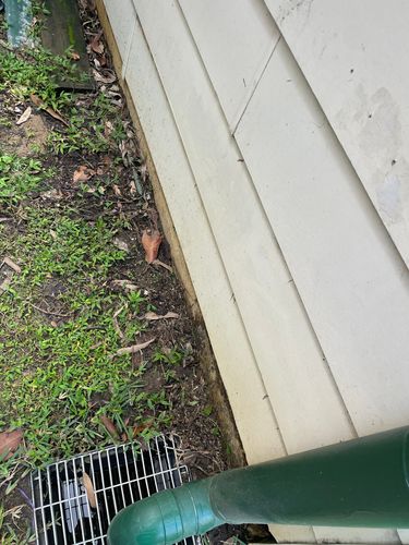

As you should be able to see I. The fourth photo the fence is higher than the bottom the shed and the land slopes down.

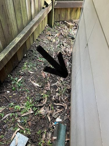

I am putting so drainage around this garage but I not sure what to do with the banked up soil between the fence and the garage …if I a I leave it as is I think it will end up in the drain when it rains blocking the drain. Please see pics.
Is there a solution that involves not to much digging ?

Hello @ChrisA
Unfortunately, there is no escape from digging if you are putting in drainage. I propose taking all the excess soil and bringing it to your front garden and spreading it around like you are topping it up. If there are any low spots in your front garden you can also put some the soil in that area.
If you have a vegetable or flower garden you can add soil in that spot. I propose looking around your home garden and see if there are areas where you can add the extra soil you've dug out.

Hi @ChrisA,
How much further must you lower the surrounding soil to be level with the top of the drainage grate? I would be hesitant to undermine the fence post footings.
If the slope towards the grate is steep and you're concerned about the soil flowing into it, you could add weed matting or geotextile matting over the soil up to the fence fixed down with matting pins and then cover it with aggregate or pebbles.

To get the soil level with the grate would require a significant amount to stool to be removed ..probably amount 250mm to 300mm….I would have to do lots of digging and hire a skip for the soil…so your idea is to just take some off to reduce the slope and cover with Geo textile matting and stones sounds excellent…could I use blue metal?

No need to even reduce the slope @ChrisA, as the matting will do a fine job of holding sediment in place; just ensure it is securely pinned in place. Blue metal would be suitable.
