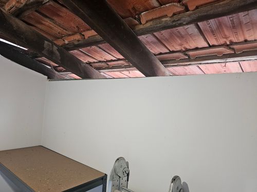

Hi all,
Hoping for some advice, I've spent days looking through google and am at a loss.
The house we bought had a outdoor room/shed added on to the porch, just an extension really. They basically just added in two walls and called it a shed. The issue is that they have left a gap between the newly installed walls and the tiled roof (about 18cm) and I can't figure out the best way to fill it.
Doesn't need to be fancy, as it is being used as a shed but just something that will keep the dust, wind and weather out. Am not expecting it to be 100% sealed, just enough to keep out dust and anything that the wind might push up under eaves. As the eaves are hanging down on the opposite side of the wall, not a lot comes through, but on windy days the dust comes straight in and I'm imagining the rain will also when we get some gusty storms.
I was thinking of just stuffing some Earthwool Insulation up there as I just can't think of anything else that's simple and easy.
Any suggestions are greatly appreciated :smile:
Thanks!

I suggest you consider attaching some Zenith 20mm Zinc Plated Angle Brackets to either side of the rafters then attaching DAR Pine of an adequate size to cover the gap. You might need to cut the timber down to get a perfect fit. Any additional gaps can be filled with expanding foam
Alternatively, you could take a strip of Sarking and use Pryda Foil Fix Strips to nail it to the top stud plate and then to the battens under the tiles. That would effectively block off the area.
Is it possible to get some photos showing the gap from the outside? This may provide some more information that our members can use to find a solution.

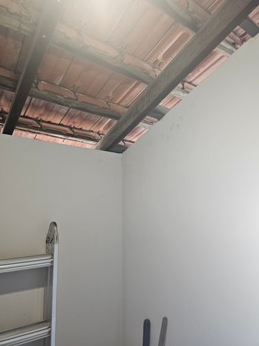

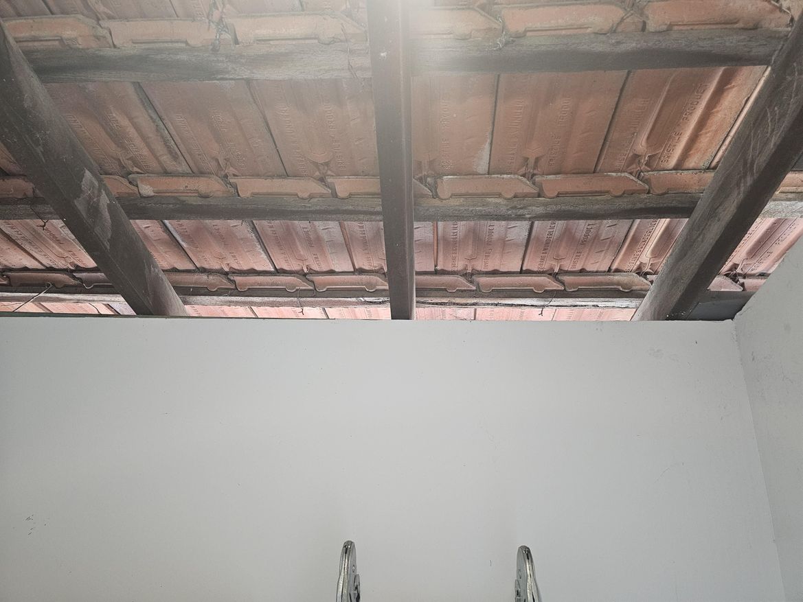

Thanks @JacobZ!
The sarking might be a way to go, I could see that working. Although filling the gap with wood and foam could also work, both really helpful ideas thankyou!
I have some more pictures from different angles as well at the other wall and from the outside

Hi @Denaz,
From the angle of the first photo, it looks like the roof batten and wall line up quite well, this will certainly make it fairly easy to go with the sarking option.

One question, if I was to go with the timber option, do you think it would be smarter for me to use a treated pine given it is open(ish) to the elements and the possibility of termites?
I think that first photo in my second reply shows the dust build up from only a few weeks from putting those shelves in! Would really love to avoid having to clean that mess out every fortnight haha
