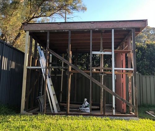

Just planning a new project here. I have this poor old shed on my property and I am looking at re-cladding it. I am getting an asbestos removal company to strip the old fibro sheets first, of course.
The framing looks ok with studs 60cm apart:
What would be the most cost-efficient and easiest install DIY cladding for the shed?

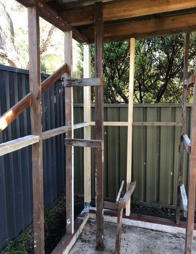

Progress is very slow due to the frame being in worse condition than I first thought and also due to weather. Difficult to get anything done ![]()
But progress nevertheless. @Dave-1 I haven’t been able to find the same size timber new let alone second hand
The corner posts are 70x70mm - which seems like an unusual size these days. I have to use two 70x35mm instead. I had to replace two of the posts as well as one more stud.
I’ve installed the brackets and secured them using 10 x 100mm Anka screws to the concrete. I am installing these into every corner top and bottom. I’ve heard that one is supposed to put screw or nail into every single hole but I’m a bit worried about splitting the old timber.

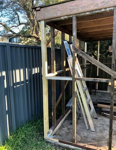

I had to cut these cross braces as the ends were rotten:
And as a result there is a bit of movement in the frame. What’s the best way to fix that @redracer01, @EricL ? A metal bracing strap? Should I get rid of what’s left of the existing cross brace first or just install it over it?

A metal bracing strap would work, or replace the timber one. Some cutting and chiseling will be needed is all. I like redoing it the original way as much aspossible as you know it worked before.

I’d love to replace the timber brace but sourcing the right type of timber might be a challenge. I measured it and it’s 73x23mm! Also, I thought it would be a god idea to run braces in both directions to form an X.

I'd recommend leaving the existing braces if they are not rotted and adding additional steel strap braces in an X fashion on all walls @tom138. Don't forget to use the tensioners too.
