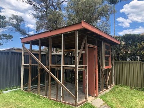

Just planning a new project here. I have this poor old shed on my property and I am looking at re-cladding it. I am getting an asbestos removal company to strip the old fibro sheets first, of course.
The framing looks ok with studs 60cm apart:
What would be the most cost-efficient and easiest install DIY cladding for the shed?

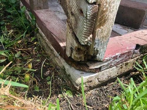

So with my other projects on hold for various reasons I’m getting back to this one.
The old cladding is gone and I’ve got new Weathertex boards sitting in the garage.
But as usual nothing is ever as straightforward as it looks. Upon closer inspection of the frame I discovered that one of the corner posts is badly rotten and will need replacing. What’s the best way of anchoring new post to the concrete base? I was thinking one of these u-shaped brackets but that would protrude and make cladding difficult.
thanks!
Re: How to clad an old shed?
HI @tom138
I suggest replacing the post and putting a new one in the same construction manner. You'll notice that the base plate of the wall frame has deteriorated as well. In its original form, the corner post would have been held in place by the top/base plate, noggings, and cross brace. The base plate would have been anchored to the concrete base.
The corner post would have been attached to the top/base plate. This in effect would save you from having to install a steel stirrup. I suggest using a minimum of 12g screws along with some Anka screws for the concrete base. I've placed an image below to give you an idea of how it might look like.I also recommend using paintable bitumen on all the bottom timber surfaces.
