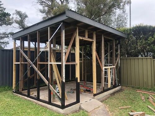

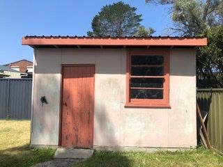

Just planning a new project here. I have this poor old shed on my property and I am looking at re-cladding it. I am getting an asbestos removal company to strip the old fibro sheets first, of course.

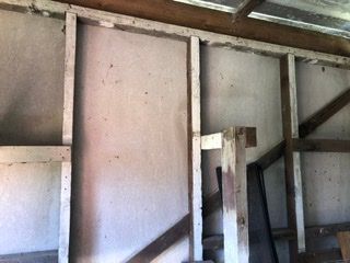

The framing looks ok with studs 60cm apart:
What would be the most cost-efficient and easiest install DIY cladding for the shed?

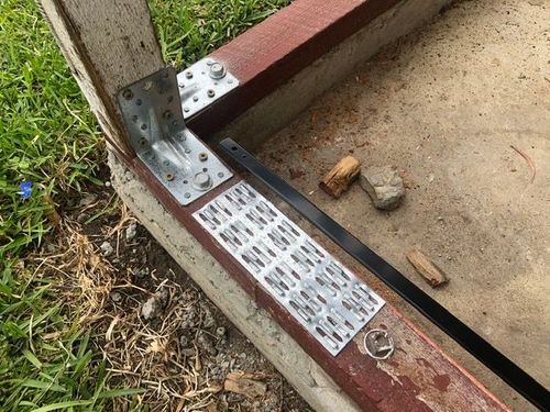

Would you be able to recommend what screws to use for the brackets ? I was going to nail them but I find it very difficult especially these top ones upside down.
thanks,
Tom
Re: How to clad an old shed?
Hi @tom138,
Standard timber screws would be fine and I'd recommend you pre-drill their holes. The alternative would be to pre-drill for your nails.
Sorry just to clarify I meant what screws to use for these brackets https://www.bunnings.com.au/carinya-90-x-90-x-65-x-2-5mm-galvanised-reinforcing-brackets-4-pack_p396... discussed earlier in this thread,
Also are these really designed to take a fastener in every hole?
Thanks,
Tom
Sorry, @tom138. I edited my above reply as I realised you mentioned the brackets, not the strapping. Timber screws a fine to use for those.
I don't believe their intention is for you to use every hole; they've just provided several to suit different purposes. Four screws on each side should be more than enough.

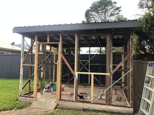

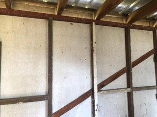

Hi @tom138
My apologies for the late reply. I suggest putting in some diagonal timber bracing near the noggings to fortify the frame. I see that you've cut off part of the long brace. This serves as a stiffener for the wall frame and if part of it is removed you'll get a bit of movement. But once you cover your wall with cladding this will reinforce the wall and movement should be greatly reduced.

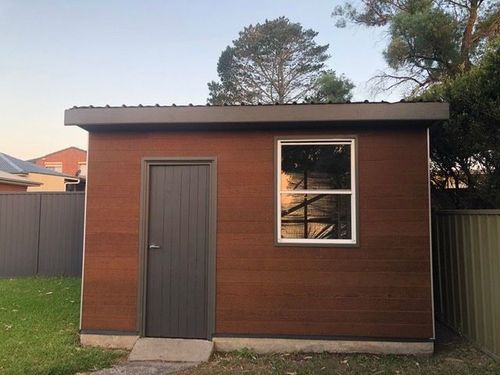

Hi all,
Apologies for not posting any updates on this for so long. I wanted to post an update when it is finished but these projects just never get 100% finished, do they? There is always the one more thing that needs to be done. And also, more importantly, there is million other jobs that need doing and so I immediately switched focus to other projects.

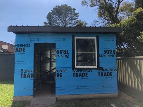

Anyways here is few pictures:
It was a great project and I learnt a lot - a bit about framing, how to install a window, how to hang a door but I also learnt to use my tools much better (and found an excuse to buy more tools). I really enjoyed this and I am quite pleased with the result.
Also wanted to thank again everyone who helped me here!
Tom

Hi @tom138,
Thanks for getting back to us with the finished project.
It looks fantastic; you should be very proud of what you've achieved and it's great to hear you learned a lot on the way.
Have you got any plans to fit out the inside with shelving of any kind? I would love to see what you do to store all those new tools of yours.
Keep us posted on all those other projects, it'd be great to see what else you come up with.
Good Morning @tom138
WooooooHooooo! That has come up so nicely! Impressed with how new it looks from what it was! Do you know how much you have spent updating it? I generally have a rough ongoing figure in my head and also keep the reciepts but never add them up
Now I really want a shed!
How much time do you spend out there? It looks like an ideal place to hang out and tinker away.
And since you mentioned it, what are the other projects you are heading towards? I have a courtyard area/gabion retaining wall and steps/ paving and a spa modification on teh plan for the year/next year.
Nice work for sure.
