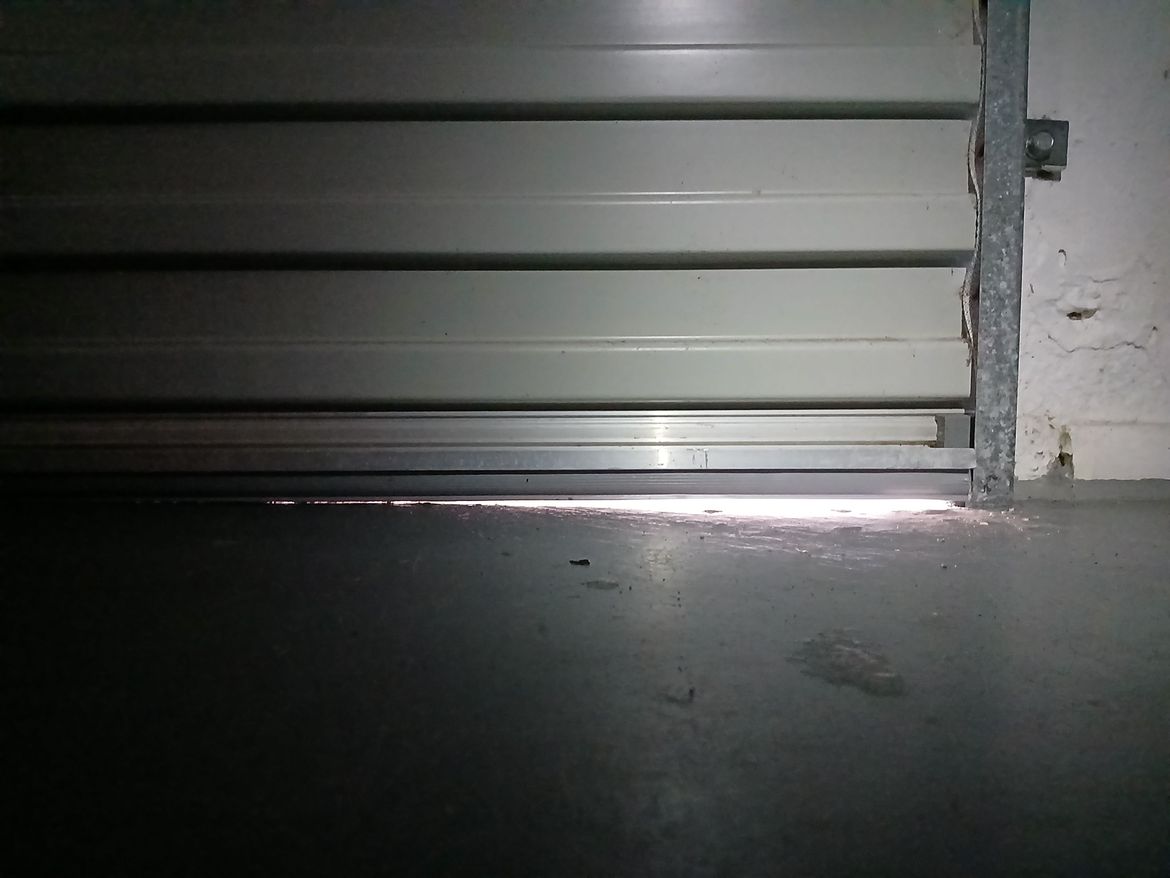

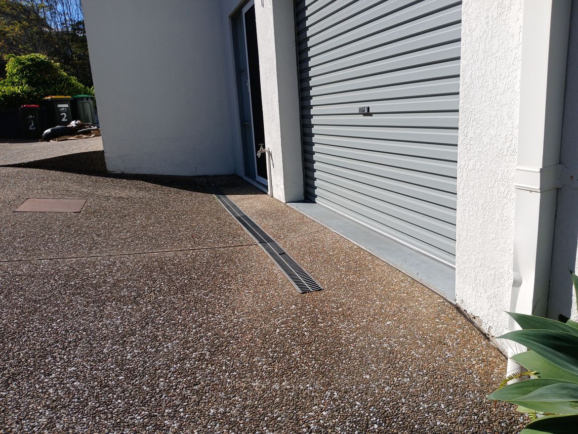

I have uploaded a couple of photos, both internal and external. Even though there is a drain in front of the garage door it cannot cope with the amount of water flowing down the driveway during a downpour and, unfortunately, the drop-off of the slope down the side of the house wasn't gouged out deep enough to get rid of excess water. Therefore, the water backs up against both my front door (and it does seep through the wooden frame - happy for any advice there, too) and the garage door. The gap on the LH side (looking from the outside) is approximately 400mm long and 8mm high at the maximum gap. There is a gap on the RH side but this is minimal and only allows water ingress during maximum downpours (which are happening more often these days).
I have checked out the Garage Door Seal and it would definitely act as a 'levee' i.e. the water level would have to be higher to enter the garage. But I'm concerned that the gap would still be there once it's installed as it would follow the contour of concrete floor so I am happy for any further advice you can provide. I look forward to your replies.Garage door gap - internal

Thank you for sharing those photos of your driveway. If the deluge is too strong and your Everhard drain is not coping, I can think of two possible options you can try. First, install two more Everhard drains at 500mm intervals. Make the additional drains longer so that it covers the entire length of the driveway. The combination of the three drains will slow down and redirect the water coming down your driveway slope.
The second option is to install a much larger Everhard drain such as the Everhard Technodrain Pro. It is a much larger drain and can accommodate a larger amount of water.

Going through the description and photos of the issue, I wonder if something like this Moroday 20mm x 3m D-Shape Rubber to be glued under the base rail of the rollerdoor. You could either go for a piece to cover the two dips either side or all the way across. (tho not confident that if you go all the way across the D will compress at the dips because of teh rise in the middle)
I would liquid nails to attach the rubber to the base of the door. If the rubber is absorbant type rubber (couldnt tell but from memory I dont think it was last time I wander in and had a look, as you do
) then I would go for something not so absorbant but same idea, something to fill that 8mm gap.

The Roll-A-Door already has a grey compressible rubber seal fitted on the bottom of the door but it is hard to see in the photo. I believe that swapping it out for the D-Shaped rubber would leave me with the same problem as the floor falls away.
Is there any product on the market that I can use to build the floor up just under the base of the door so that it would seal between the door and the floor?

I dont know of any product that would fit that description without it becoming a trip hazzard of some kind. Having the D rubber mounted on the underside of the roller door only where the dips of the concrete are on the sides would solve the trip hazzard. (So not the whole distance across. ) will have a think of other materials that could be used and still keep your door secured.
