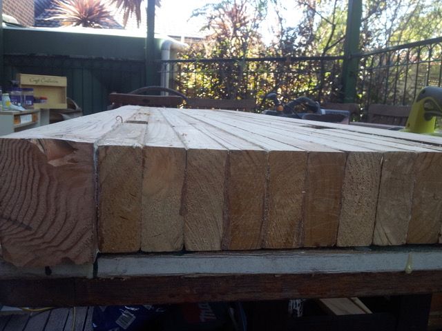

Before

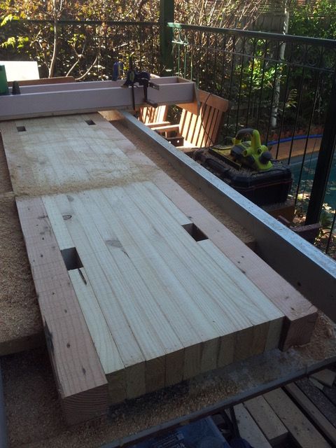

During levelling with a 'DYI' router/sled and levelling jig

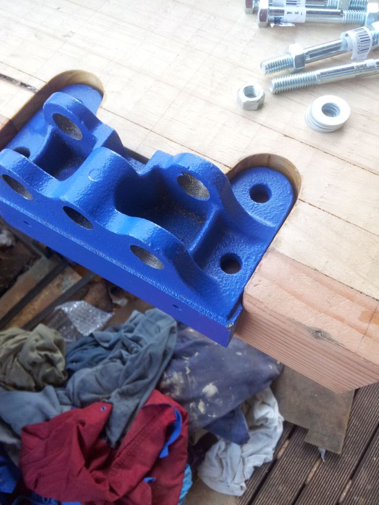

Have commenced fitting my new vice (on special at Bunniungs Moorabbin) Now that is a nice fit
Routed out the underneath side of the workbench to install the vice at the optimum height

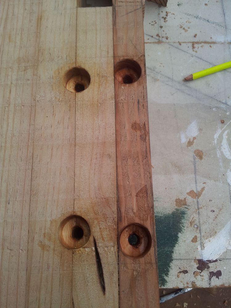

I never liked coach bolts as they seem to 'work loose' over time so have opted for through and through bolts counterbored and the wooden plug (jarrah or even ebony) to 'hide' the holes on the top of the workbench. I have added a little varnish to seal the oregon rail and pine top.
Counterboring
