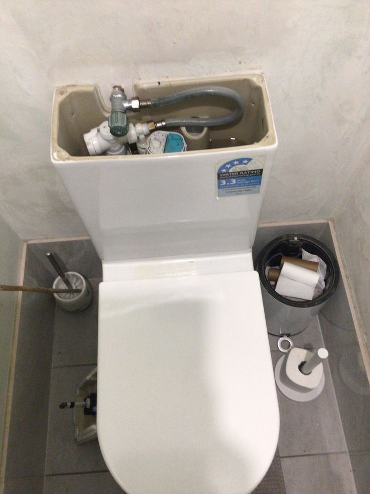

Hello just wondering if Evekare Smart Bidet Toilet Seat With Remote would Work on Our Toilet
photo below of our toilet

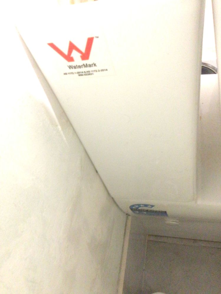

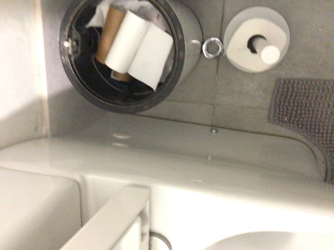

The good news is that the evekare Smart Bidet Toilet Seat With Remote will work with your toilet. However, you'll need to engage the services of a registered plumber that has experience with installing bidet seats. The installation will be involved and possibly require new plumbing fittings.
The plumber might possibly offer two options. First is to drill through your cistern and attach a plastic hose to the cistern tap inside your cistern. The second option is for the plumber to cut into your wall and attach a new tap for your bidet seat.
