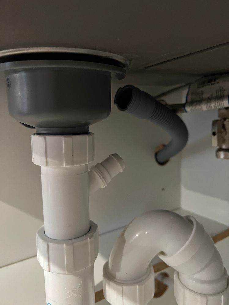

Hi, to connect this washing machine drain hose underneath this sink, do I just connect it and secure a hose clamp over it? Or is another attachment required? Thanks for the help.

The tip on your outlet hose should be made of rubber and can be extended past the corrugated part of the hose. This rubber piece will sit on the spigot and be secured with a hose clamp.
Check out How to connect a dishwasher for some guidance.
