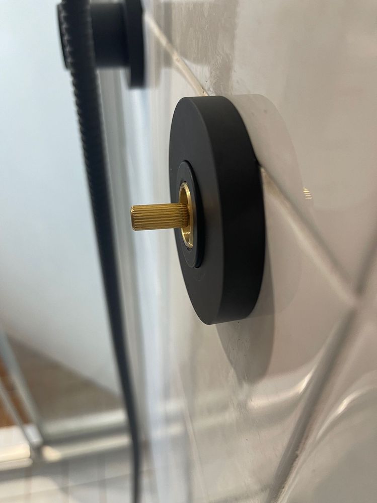

I have recently brought new mondella pin lever 1/4 turn ceramic taps - https://www.bunnings.com.au/mondella-black-resonance-pin-lever-wall-top-assembly_p5004187
However once installed we don't have enough spindle left to properly attach the cover plate, tap handle and secure the screw so that the tap handle doesn't fall off we are only maybe 2/3mm off it working (the handle can be attached without the cover plate).

We're having this exact same issue with the very same taps. Did you ever find a resolution to bring out the spindle far enough to get the cover flange and tap both fitted?

We tried the https://www.bunnings.com.au/kinetic-28mm-ceramic-disc-spindle-extender-2-pack_p5050142 but they then extended the spindle out too far to the point the cover flange wouldn't sit flush against the wall. If only they came in a shorter size than 28mm! I know you can purchase 'trouble domes' to fill in the gap but we would prefer to not have those for a cleaner install. When we also fitted this, it worked fine for the first 20 minutes during the shower then it started to squeal (usually a sign of high water pressure) then after the shower and water had been off for say 5 minutes - there was a 'pop' followed by the hot water coming on despite the tap being off so we had to remove it. What would be the cause of this if you happen to know?

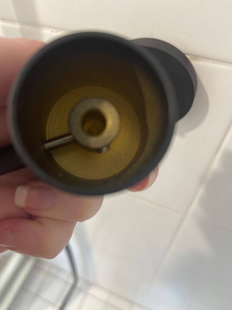

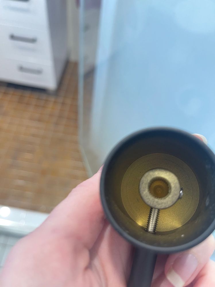

@Vic477 We did end up solving the issue although I’m not sure Bunnings would recommend doing this.
We ended up having to drill a small hole into the spindle end. Added a screw and then wrapped copper wiring around the screw so it was the same width as the spindle itself. You wouldn’t be able to do that if the handle doesn’t catch on the spindle at all. (We we’re ok because there was enough overlap for the tap to still function. Like the handle worked without adding the screw it just wouldn’t stay on the spindle.)
Then we did the nut up on the handle. So far it’s held good!

I don't suppose it'd be too much trouble to take a photo of the screw you fitted to the end of the spindle when you have some time just so we have a better idea as we could try that before we opt on removing it all in turn for another brand of spindles?
We have, what feels like, 3-5mm of overlap from the spindle with the cover flange fitted so think this should be enough for the splines to catch (hopefully).
