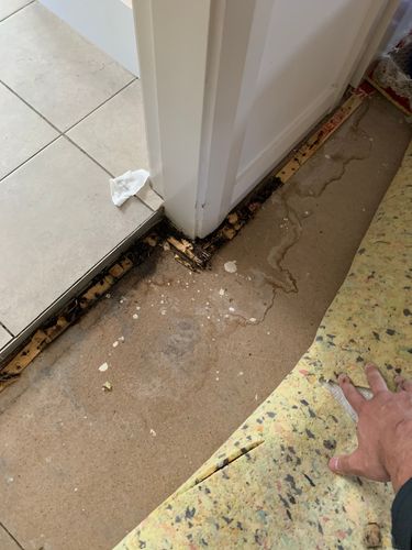

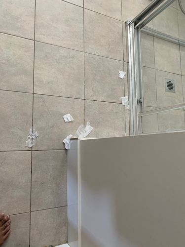

Recently bought a place and moved in. Noticing now there are leaks around the shower area. Also ripped a part of the carpet infront of the toilet and noticing damage there. Added pictures. The wet toilet paper areas are where we can see water seeping through.
Really disappointed with this and am worried about the extent of the damage. This did not come up in the building inspection which is surprising to me. Maybe I am wrong abt that one.
Anyone had similar issues?

Hi @eemrun I must admit I hate leaky showers and fixing them can be very trial and error. Step 1 Id check to see if you have any comeback on original builder, good luck with that. Step 2 make sure not leaking down back of taps ie do you get water when shower not used - unlikely Step 3 you dont appear to have a hob, shower is on floor a thin bead of silicon clear or colour to match tiles along all internal edges of shower both vertical courners and along floor joint. Bead only needs to be 2 or 3mm thick on each edge. Make sure you don't leave any breaks. This fixes most leaks in my experience. (Make sure you have liquid detergent on you hand or scribe when you smooth it out , stops it from sticking to you and clean up as you go). Step 4 try a shower sealer like crommelin shower sealer and waterproofer available ar Bunnings Step 5 call a plumber this may require removing tlies and resealing pan. In my experience 90% of the time step 3 solves the issue. JDE

It's great to see our members assisting with your issues. Before I get too far into potential fixes, can I clarify if this water is tracking across the tiles where you've placed the toilet paper, and the source is the shower screen where the last pieces are placed? If so, it's going to be a reasonably easy fix.

Thanks everyone for your suggestions. I eventually went with a plumber who went with something similar to option 3 as @JDE mentioned. The builder took care of the plumbing issue. Fingers crossed this solves the problem.
