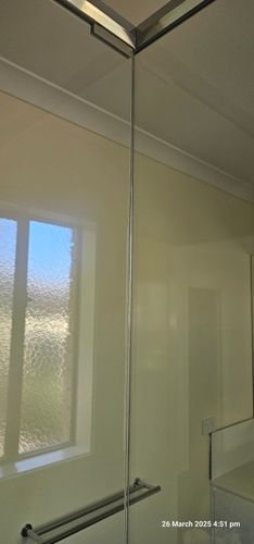

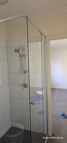

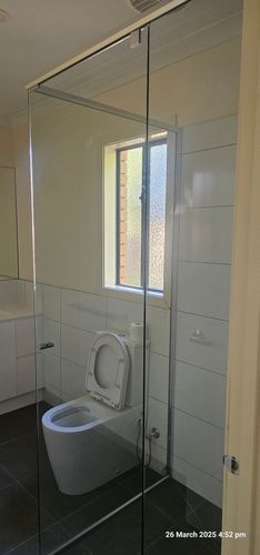

I am new to this this group and my recently purchased property's shower unit leaking water through the both side of the doors. It's frame less unit without any seal on the side of doors. Doors can be open both ways.
Kindly give your suggestion to solve the water leaking problem through the side of doors.
Kindly see the the attached picture for your reference and waiting for your valuable opinion.

If you are aware of who your shower manufacturer is, I suggest giving them a call and asking them if they have drip strips that will stop water from coming out the gaps of the glass. However, if you don't know who your shower manufacturer is, I suggest looking at the Sandleford shower seals. They come in a variety of styles and are sized to fit 6mm and 10mm glass panels so please choose carefully. It might be possible to fit them to your shower on the condition that the gaps are big enough.
