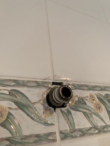

Would it be possible for you to post a photo of the wall outlet and the back of your new shower attachment. It's possible that an adapter was removed along with your old shower head assembly. If it was accidentally removed, it might be possible to screw it back on and thereby allowing you to screw the new shower head assembly on.

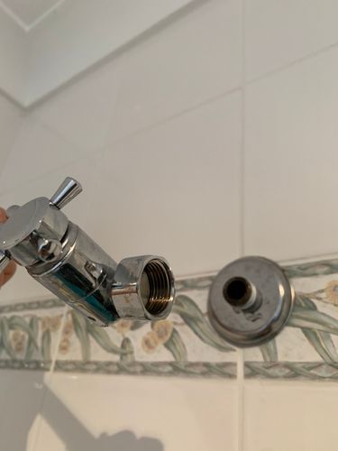

Here are the photos:

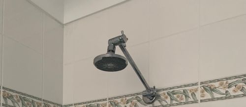

and the old one:

Hi @rpiad82,
Is it the thread on the new shower arm that is larger than what's on the wall? Does it just slide over the thread on the wall and not grip it all?
Most threaded fittings on walls for showers are 15mm, which suits all available shower arms in our stores. If the sizing is different, you might like to take your old shower arm into the store with you so our helpful plumbing expert can examine it for you.
Alternatively, if it's just leaking when installed and screwed on, then it could just need a couple more revolutions of thread tape. However, it sounds like they are completely different sizes, which is unusual.

Thanks, @MitchellMc.
The new shower I bought was the Flexispray Havana Short Twin and the thread is smaller than what’s on the wall. I can only do one revolution and it get stuck unlike the old one which gets more than half way and you tighten naturally.

Hello @rpiad82
Thanks for posting those extra photos of your wall outlet. I suggest doing a quick test, remove all the thread tape on the outlet and brush off any debris that is on it. Don't put any tape on the outlet and see if the new fitting will screw on properly.
If it does screw on properly, odds are that there is too much tape being applied. I propose putting a minimum of two rolls at the front and three going to the rear. However, if the new fitting does not screw on properly with no tape on the wall fitting, it's possible that the unit you have is defective. I suggest bringing it back to the store and exchanging it for a new one.
Re: How to replace shower head with bigger thread
Thanks, @EricL!
It worked! I just had to try harder with a wrench to screw in the new shower. I hesitated because the old one was so easy to screw. Now it’s in and working. Thanks!
