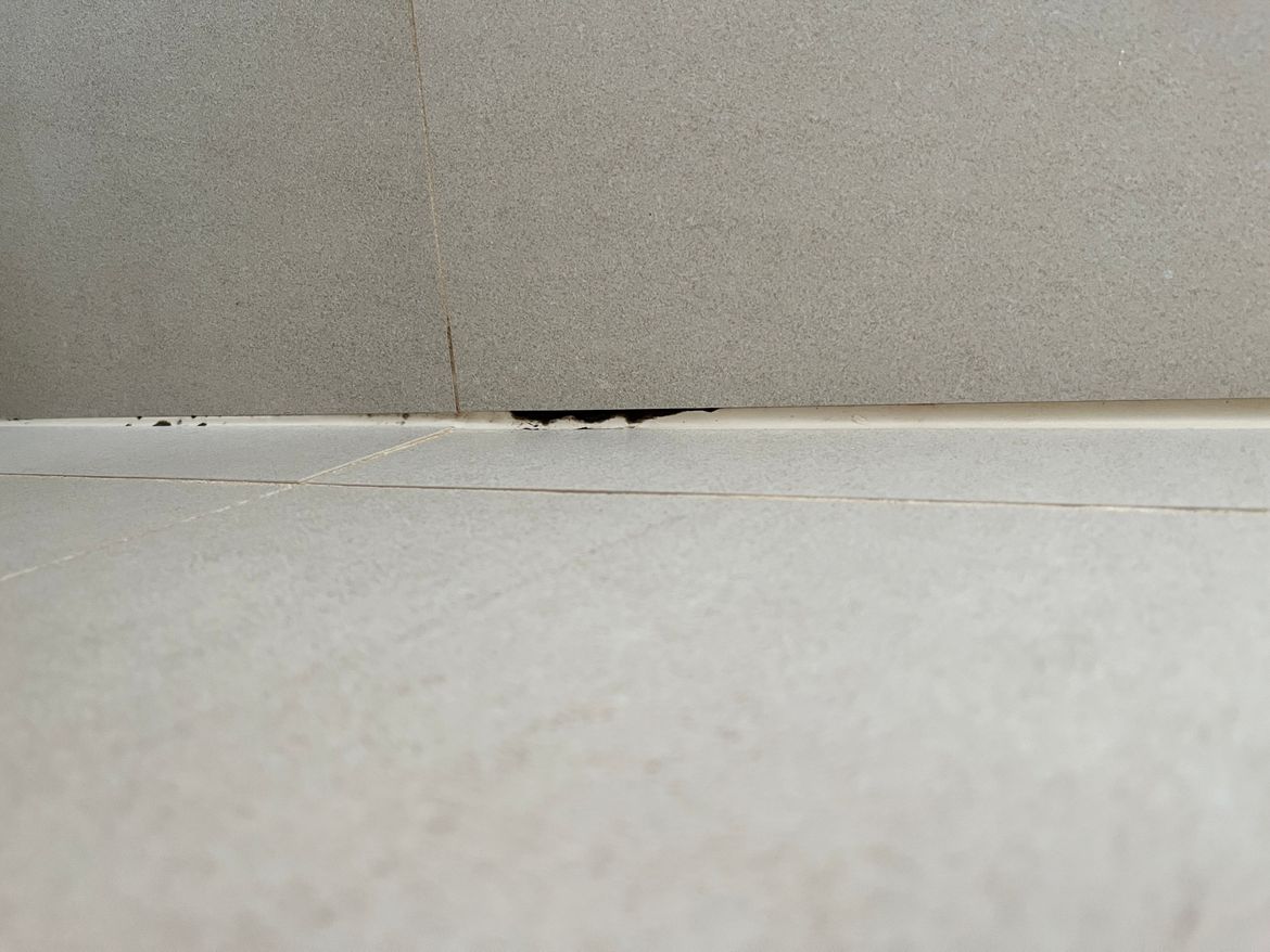

Hi all,
Needing some advice about my shower.
1/ Is it possible to add grout as we have some missing parts
2/ Would this be mould? What would be the best way to remove / treat it? I have tried using mould remover which hasn't been effective so would I need to remove and silicon and reapply? This is between floor and wall tiles.
Re: How to replace grout?
Hi @smhok
I suggest having a look at this discussion - How to repair floor tile grouting? by @lukec. When replacing grout, I often suggest using a multitool in combination with a Diablo 70mm Multi-Function Tool Ultimate Grout And Mortar Blade. However, if you are only doing a small repair, I suggest using QEP Carbide Grout Saw. I propose removing only what is loose, chipped and damaged.
Before filling the gap, make sure that it is clean and free of debris. I recommend using Dunlop 800g Ready-To-Go Coloured Grout in combination with a QEP 6" Handyman Squeegee. Wipe off any excess grout with a damp sponge and don't allow it to dry off on top of the tile.
In regards to the mould on the silicone sealer, if it is too well embedded it will need to be removed and replaced. I suggest using Selleys 300g White Wet Area Waterproof Silicone Sealant. I recommend using CornerTape Standard Silicon Remover to remove the old silicone.
Please make sure to wear personal protection such as gloves, goggles and a dust mask when repairing the grout lines.
