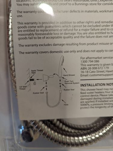

I'm replacing a broken shower head and the replacement instructions shows the pipe extending from the wall. (Photo attached)

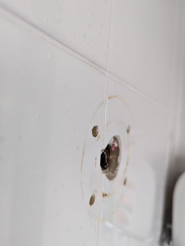

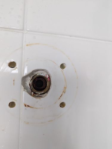

But my shower pipe doesn't extend past the wall. (Photo attached). What are my options? Is there some sort of extender I can use, or do I go back to Bunnings (woe is me) and get a shower head that screws into the wall?

My apologies for the late reply, I suggest using the following parts so that you can attach your new shower head to your wall. I recommend the Brasshards 15mm Brass Male / Female Threaded Adaptor followed by the Brasshards 15mm Brass Threaded Hexagon Nipple. Before you screw them into place, I suggest wrapping the threads in FIX-A-TAP 12mm x 8m Thread Seal Tape to prevent leaks.
If the screw holes are no longer to be used, I suggest covering them with Selleys Ezi Press 100g Wet Area Silicone Sealant.
I've placed a sample image below to give you an idea of how they can be put together. Please remember not to over tighten the brass fittings to prevent damaging the copper pipe behind your wall.
Thank you! That is what I did, worked a treat!
