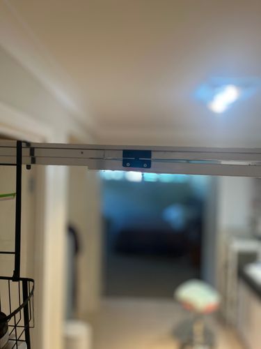

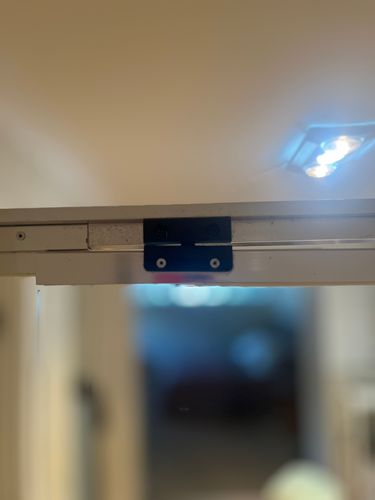

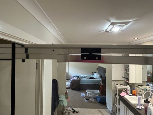

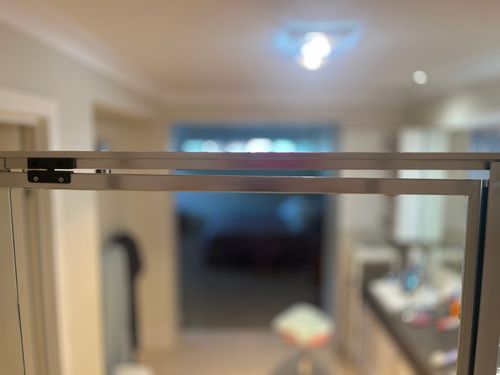

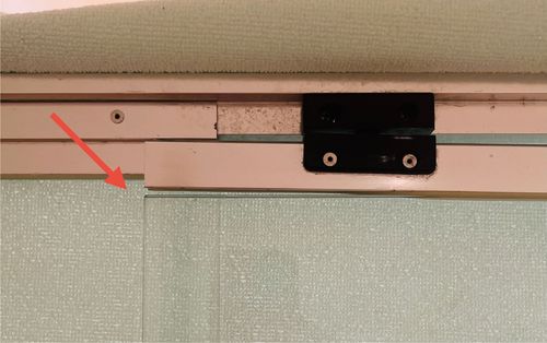

I have a glass shower screen with a pivot door and one glass panel each side.
I noticed the door is hanging uneven, and the panel on the side the door opens is also uneven. The glass is also starting to slip from the frame in one corner.
Can this be repaired or does the whole screen need replacing? Is this a job for a glazier or a handyman, or something relatively easy I can do myself.
Attached are photos.
Any advice greatly appreciated 😊

With this being said, it looks like the frame around your door panel has shifted, meaning the panel has dropped out of the channel at the top.
Is it possible to get some additional photos? Specifically, the bottom of the glass panel and the gap to the ground, a photo showing the gap on the side of the panel opposite the pivot hinge and a photo of the corner where the vertical frame hits the horizontal frame at the bottom of the panel.
The aluminium frame has likely shifted at the bottom corner, or the pivot hinge at the bottom has allowed the frame to drop.
It may be possible to fix it yourself, but I would have to see those additional photos to advise you exactly how to go about it.
