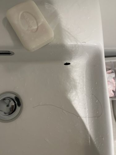

there is a little hole in my bathroom’s sink, how can I fix it easily and cheaply. what kinds of tools I need to have?

Welcome to the Bunnings Workshop community. It's sensational to have you join us, and thanks for sharing your question about your porcelain sink.
I suggest using PC-11 56g White Epoxy Paste to plug up the hole in your basin sink. Take a portion of the putty and mix it very well in your hands to make sure that it activates. Place the putty over the hole but don't push it into the hole. Your goal is to cover the hole without the patch being too pronounced. Feather the edges so that the putty blends into the basin. Please keep in mind that the patch will dry off white and will not match the stark white finish of your basin.
