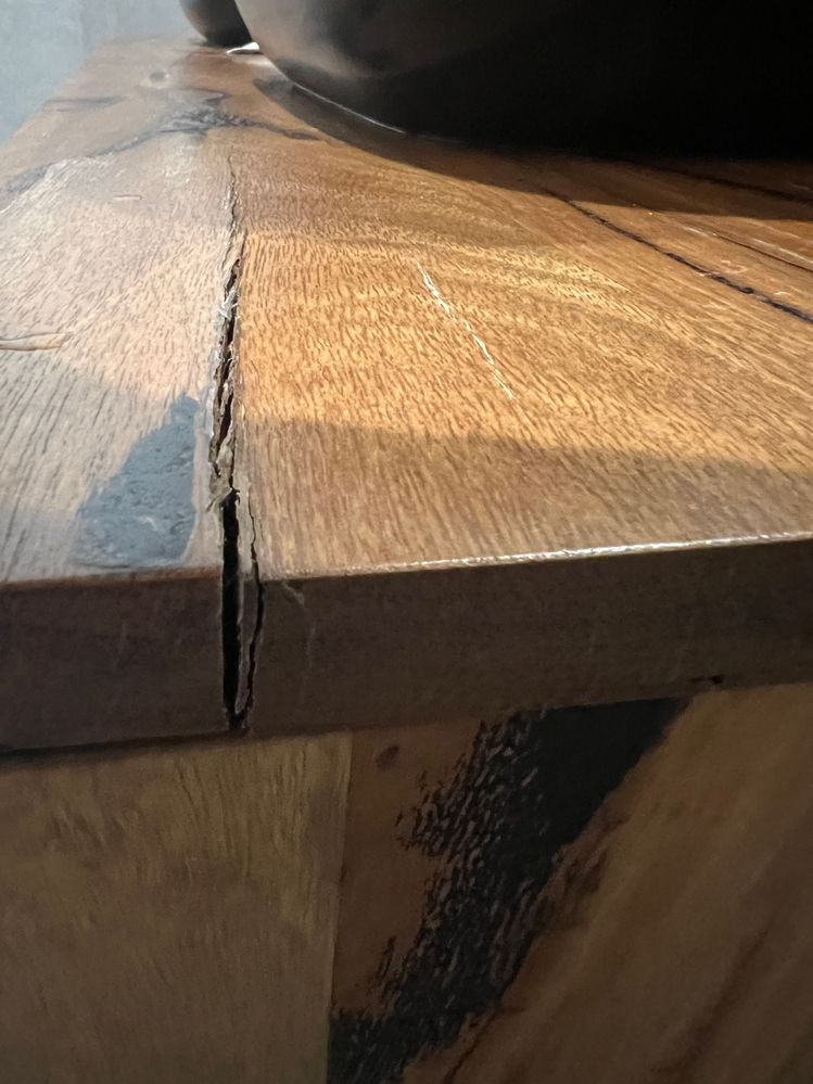

How to repair cracked benchtop?
Two months after moving into my new home, the wooden benchtop in my bathrooms started to peel and crack noticeably.
I'm hoping to get some expert advice on repairing it or something else if it is not repairable.

Welcome to the Bunnings Workshop community @hale. It's splendid to have you join us, and many thanks for your question about repairing a benchtop.
It sounds like the issues with your wooden bathroom benchtop, such as peeling, cracking, and splintering, could be due to either inadequate seasoning of the timber or insufficient sealing, which allowed water to penetrate the wood. If the timber wasn't fully seasoned before installation, it may have absorbed moisture over time, causing it to expand and split. Similarly, if the benchtop wasn't sealed properly, water could have seeped into the wood, exacerbating the problem.
There is a possibility that the benchtop can be restored, depending on the extent of the damage. One approach would be to carefully remove the benchtop, then glue the crack and clamp it back into position to close the gap. Once the crack is sealed, the entire surface would need to be sanded smooth to eliminate any rough spots. Another option might be to fill the crack with black-tinted epoxy, which can provide a strong, durable repair and blend well with the wood’s natural grain. After either method, the benchtop would need to be refinished with a new protective coating.
If water penetration is indeed the cause of the damage, it’s important to ensure that the area is thoroughly sealed after repairs to prevent further moisture ingress. You should apply multiple coats of a high-quality wood sealer or varnish to create a robust barrier against water. Additionally, regularly maintaining the seal will help prevent similar issues in the future.
Given that this is a new home, you might want to consider contacting the builder, as the damage could be covered under a warranty, especially if the issue stems from construction-related faults, such as improper installation or the use of inadequately treated timber. The builder may be able to assess the situation and arrange for repairs or replacement, depending on the terms of your warranty. It’s worth reaching out to see if they can help resolve the issue.
