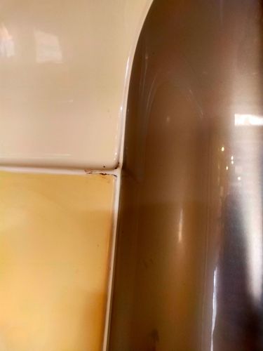

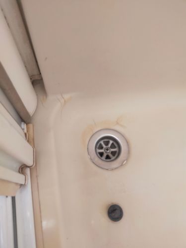

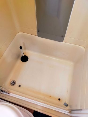

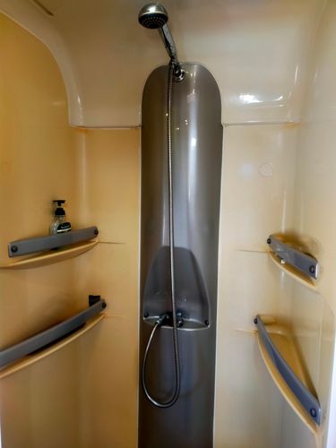

Shower is an acrylic, plastic (not ceramic.
Need to repair hairline cracks.
What product and how to tackle it?

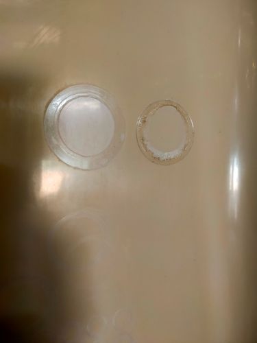

There is super glue residue where things have been stuck on the wall..how to remove?
I also want to redo the 'silicone(not sure of correct name)' in the shower where it has started to degrade.
Then I plan to repaint beginning with base to test my skills and on to walls if I am indeed a handy diy er 😁.
Product to repaint and steps.
It is a small shower so wondering what volume of paint will be needed.
Thank you in advance.
Hello @BusyBirdie
Welcome to the Bunnings Workshop community. Its sensational to have you join us, and thanks for sharing your question about your acrylic shower.
For acrylic showers, we generally recommend using PC-11 56g White Epoxy Paste to fill cracks and fissures. I'm sorry, but the store does not carry any paint system that will work on an acrylic shower. I suggest engaging the services of an acrylic shower restoration specialist. They will have the knowledge and equipment to properly restore your acrylic shower. Using ordinary paint is not an option as it will not adhere to the surface of the acrylic panel and will just peel off.
Let me call on our experienced members @twocutekelpies and @Peggers for their recommendations.
