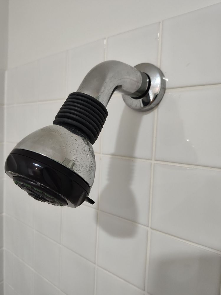

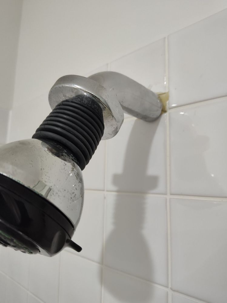

Hi, Does anyone know how I can remove this shower head for replacement. There is a large chrome sleeve covering the water outlet on the wall so I assume I would have to remove that first to get to the outlet but can't see how to do that.
Thanks

I suspect the male threaded wall fitting is screwed directly into the female threaded fitting in the back of the shower head shaft. To remove, you'd turn the whole shower head assembly, which should unscrew it from the wall.
Here's a helpful guide: How to replace a shower head. Although it might not specifically assist with your question, it will give you an idea of the internal fitting and will benefit others coming across the discussion.
Re: How to remove shower head?
Thanks Mitchell, That worked and I'm now off to Bunnings to buy a new shower head.
