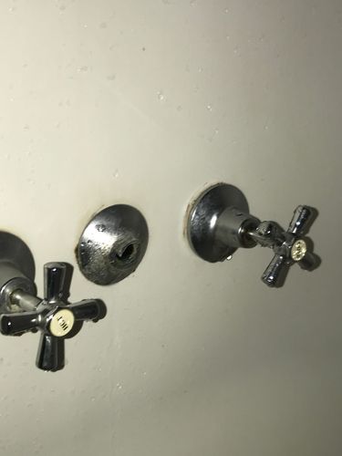

Hi. Wanting to remove the very old spout as it broke on half and disintegrated like pewter. I had about 3cms of it protruding out from base just enough for pipe wrench. But as soon as I started to turn it disintegrated even more to now what you can see. It was so brittle. The pic from Bunnings is the style of the original and also what I bought to replace it.

That's a bit of a pickle! It's going to be very difficult to remove the end flange of the bath spout now that it has snapped off. If the flange section has also deteriorated you might need to start destructively removing it and perhaps cutting into it and then prying away the pieces. If you can cut/break away the sides of the flange, then that might give you some surface area you can lock pliers onto and undo the rest.
This could be a job for a plumber, but I suspect they will struggle with this one, too.

Ouch and a few more curses for you, I have struggled with removing cowls from old taps before and I and at least a little more to hold on to give me grip and turn.
Maybe drilling a hole a midway between the center and the edge of the tap base 6mm (thinking about it maybe a little bit closer to the edge then the center to give the best torque when tapping), then you could use a flat head steel shafted screwdriver (We use to call it a suicide screwdriver while working on electrical stuff but cant find teh actual name of it) and tap it counterclockwise (I think but always get it wrong) I was thinking along the lines of a large pinned circlip plier but dont know of any with that solid a nose. I have removed plenty of things this way, takes patience and gently tapping more then clobbering it. Plus a lot of crossing fingers

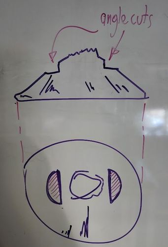

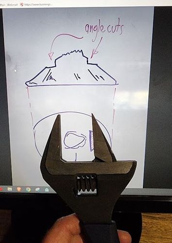

If you're good with an angle grinder - cut two parallel 'half-moon' sections from the base - equal to a good sized shifter.
It'll either shatter or turn. I guess both outcomes would be good?
