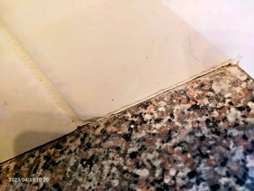

Thanks @MitchellMc .what do they usually use for in between tiles.. it doesn't look like elastic like sealant but Powderly white? Can this be replace with those.basin sealant?

Hi @calccom21,
It looks like they've tried to cover the gap between the tile and bench with cement-based tile grout. It's the same hard grout used between tiles. This joint is typically done with soft and flexible wet-area silicone. When you install the new bench you can fill this gap with silicone.

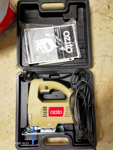

Also I'm planning to make a study table and I have a jigsaw and circular saw. Anyone know if it able to cut hardwood?
It was ozito corded think 400w
And the circular saw is Bosch pks1500 (1500w)

A corded jigsaw has more power than a cordless one and can cut through hardwood. However, it's important that you get the right type of jigsaw blade for your tool. I suggest visiting your local store and speaking to a helpful tool shop team member and explaining to them what you're after.
In regards to your Bosch PKS1500, it's powerful enough to cut hardwood, just remember to get the right saw blade for your tool.
