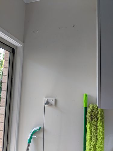

How to mount a Dryer to the wall with only one stud?
I am trying to mount my dryer to the wall in my laundry but the only stud I can find seems to be pretty centred to the space available.
How do I mount this securely in this space?

Welcome to the Bunnings Workshop community @peart15. It's tremendous to have you join us, and many thanks for your question about mounting a dryer.
You're going to need to establish at least two secure mounting points. Have you got yourself a stud finder? You'll need to go over the whole wall and locate any solid timber there. You might find something close to the window, next to the cupboard or at the top of the wall. If you can find some more timber, we could try and work out how to affix some type of bridging timber between them to give you two central mounting points.
If you're successful, please indicate on your image where the timber is that you've found, and I trust our knowledgeable members will have some solutions for you.

like what @MitchellMc has said, try to find as many studs along that space. There will likely be something close to the door/window on your left and the cupboard (that cupboard would be attached to something). I too had the same problem (plus I have a steel frame home which makes it more difficult to find studs!) and ended up attaching an external piece of timber between 2 studs and a horizontal support then attaching the dryer to this.

What you've shown is exactly what I'm hoping for. If we can firmly attach a bridging piece of timber, even off-center between studs, that will give us a solid mounting point for the dryer.
