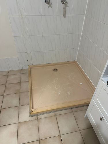

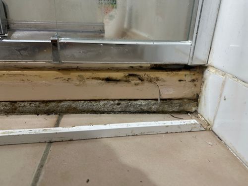

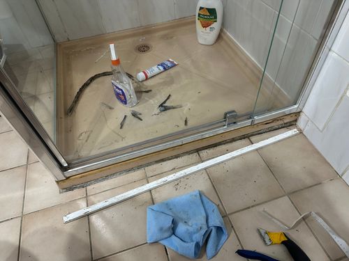

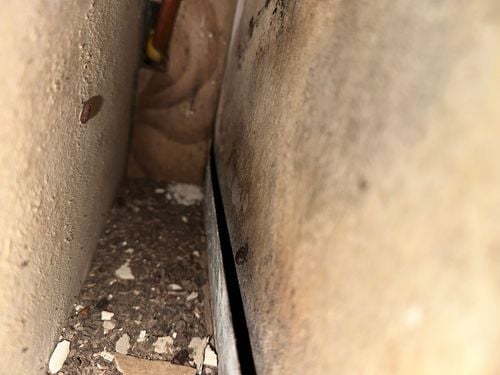

we moved into our 80s built house in May last year and immediately had waterproofing issues with the shower. It looked like the previous owners had removed the original shower screen and plonked a new one on top of the plastic shower tray without sealing it, judging by the amount of water that ended up on the floor on the first shower. I applied a fair bit of silicone, which seemed to fix it reasonably well except for the occasional bit that would pool on either side of the screen depending on how the water hit it. 8 months later I finally had enough and ripped all the silicone out to see what was. It turned out the shower tray was lower at the front and the previous owners had “sealed” a right angle metal moulding against the tray to make it flush with the base of the screen 🤬

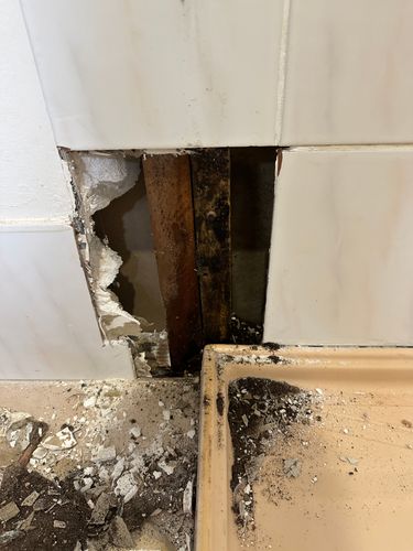

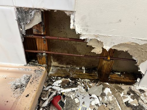

Today I removed the tiles on either side and as I did so my chisel went easily through the gyprock underneath once I got through the grout. Once I got the tile off, the remaining gyprock was so damp it broke apart with minimal pressure. Behind, the wall stud and bottom plate were also damp and rotting. I haven’t taken all the tiles off but I’m thinking that I’ll find similar issues along the shower base and that the previous owners had just siliconed over a previously failed seal. I’ve noticed the start of some mould so I have sprayed the area with mould killer.
