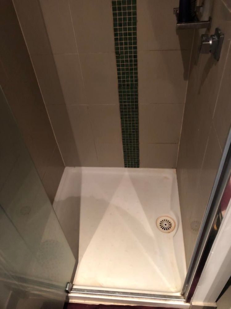

Hi A have a sruface level chip in the shower basin
I have been told it is surface level but would be happier if I could put some waterproof covering on it and maybe in white cover
I think the shower floor is acrylic Bu ti don't really know
I need something easy to apply thx Jess

I suggest using Selleys 50g Knead It Aqua Epoxy Putty to patch the damage on the surface of your tray. My best advice is to mix only what you need and to feather the edges so that it does not stand out too much. Make sure to mix well to get full activation.
Please note that the putty will not be the same colour as the tray and will dry a light grey colour.
