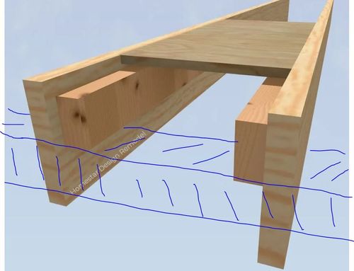

I think I may have misinterpreted what a noggin was...! I now realise it's the bracing element between studs or joists...! Whoops!
For option 3, I meant the noggin was the 70x35 timber to be fixed to the side of the joist like in the image here. Except in my bathroom the bearer is the crude sketch I've made in blue. Because the joist is only 90x45, the blocking timber (really not sure what else to call it!) will not only be fixed to the side of the joist, it will also be resting on the bearer. Thereby maintaining the weight bearing properties of the joist and bearer and not compromising structural integrity, or not?

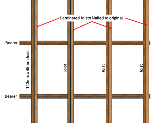

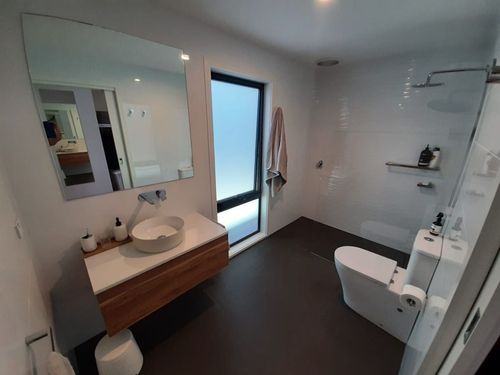

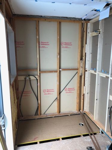

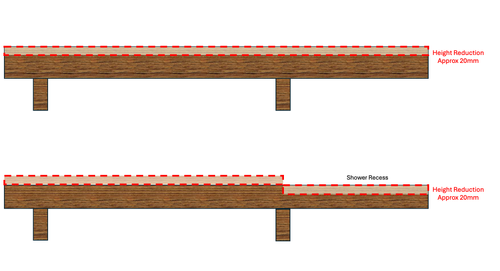

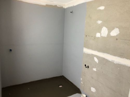

Hi @squeakysim
Personally I would do what ever it takes to ensure there is little to know step. So, I'm with @JacobZ in considering Option 2 which is one I have done myself in both an ensuite and master bath. I pulled up all the floorboards, then hired an industrial electric planer that was similar to this one that I could crank the depth right down as it had the power to take 2mm off per pass. But as @JacobZ highlighted, this reduces the structural strength of the joists. So I laminated 70mm x 45mm structural pine to each one and packed them where required to the bearers. This was pre-approved by the building inspector.
For the shower recess joists I made a couple hundred cross cuts at the right depth with my circular saw. It didn't take as long as it sounds. Then it was a quick knock out of the sections with a hammer and wide chisel. I never knew about products like Sycon (possibly wasn't around). I laid down 2nd hand yellow-tongue which I think I got for free. These were supported by additional noggins and joists on all joins.
Then tile underlay was placed on top and the room waterproofed. I think I about 2-3mm out on the finished level to the WIR carpet which was never noticed.
Regards Nailbag
Thanks for that @Nailbag !
What size were your joists and how much did you end up taking off them?
Also, can you explain what you mean by laminating the timber to the joists?
Hi @squeakysim
Refer to images below. Measurements are best guess from memory as it was several years ago
Nailbag
