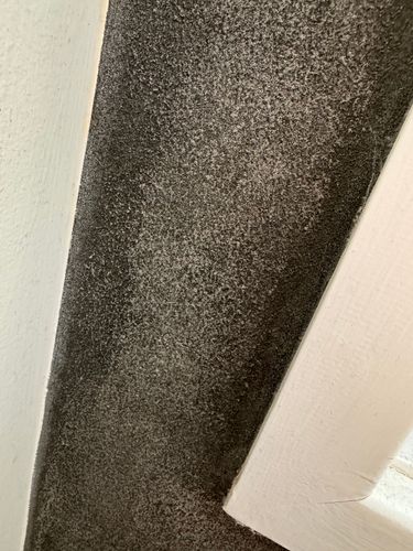

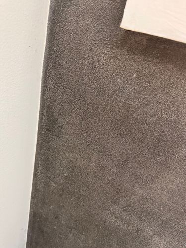

 hi! I have this weird textured covering/paint in my bathroom, it it’s like sandpaper. Can I paint it/tile over it?

I also wanted to warn that your ceiling could contain asbestos. Please do not disturb it. You can ask an accredited National Association of Testing Authorities (NATA) asbestos testing laboratory to confirm the presence of asbestos. For a NATA Lab List call 1800 621 666 or refer to their website at www.nata.com.au.

it’s on my wall, not the roof, I’m sorry. It looks like sandpaper.

As Jason mentioned, please have it assessed for asbestos before working on it.
I think the simplest solution would be to cover it over. If you are looking to create a feature, you could use Easy Craft 9 x 2400 x 1200mm easyVJ100 Primed Wet Area Interior Wall Lining. Many of our members have used it in their bathrooms, and it can look stunning. Check out @craftyhopper's amazing Bathroom makeover on a strict budget. Alternatively, we also have products like Wall Art 2400 x 1200 x 3mm New York White Tile Wet Area Wall / Shower Panel for a fresh tiled look.
You could tile over it, but given it's an unknown coating, it's difficult to tell whether it would support the weight of tiles.
