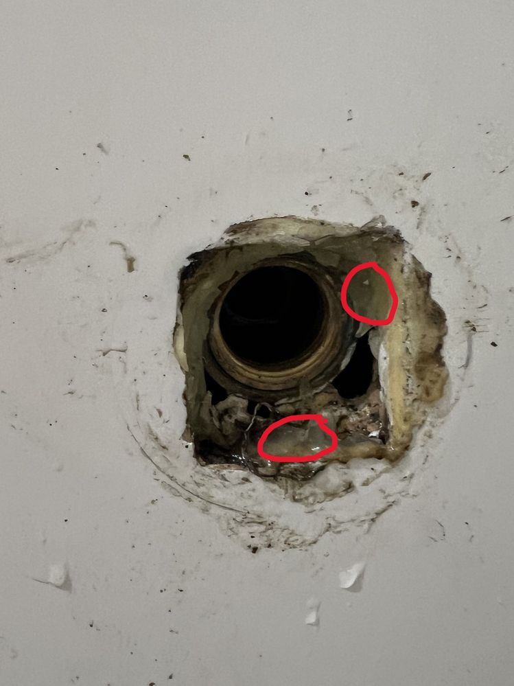

When I open up the cover, I see a kind of a gel (in the red circle in the photo) to prevent water from entering the wall. Can anyone suggest where to buy it? I just don't know what we call it.
Also, will a brass washer be better than plastic one in this case?
Thank you so much for your help!
Danny

That would likely be clear wet area silicone, which you can apply with a caulking gun. Ensure you fill those gaps where you can see into the wall cavity.
Regarding the washers, either a plastic or brass one would be perfectly fine to use. I wouldn't say the brass ones are any better, as the plastic will last just as long.
