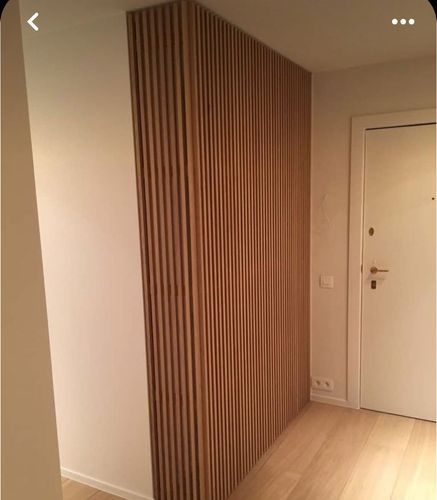

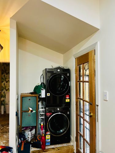

First time poster , please excuse mess. I am looking to make a hidden door / feature wall from wood panels for this tiny euro laundry / will be broom storage. It has slanted celing from 2 metres - 2.3” and approx 1300 wide.

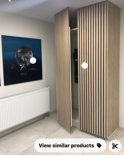

Looking online it looks like custom making doors from plywood would be thr best way to take advantage of storage above the machines. I have attached few images of the kind of look.

I suggest thinking about building a door frame first that can house the hinges. It does not need to be complicated, just a basic rectangular frame to serve as the base for the hinges and doors to hang onto.
I propose having a look at the Prempanel 2700 x 600 x 21mm Oak Timber Acoustic Panel which has the appearance you are after. A regular 600mm pantry door has a typical weight of 18kg, the Prempanel has weight of 11kg which allows you to build a timber door frame around it.
I suggest using the Kaboodle 600 door pantry hinges, these hinges have been tested to carry the weight of a standard 600 pantry door and should be able to carry the weight of your Prempanel door.
