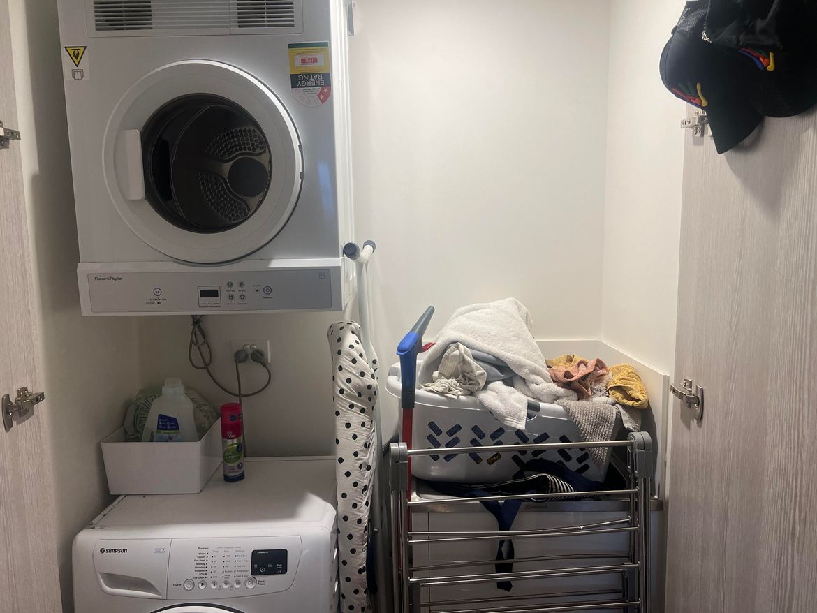

I have one of those "closet' Laundry rooms and i want to improve the storage without spending too much but also don't have a great idea where i should start.
I want to put a bench-top over my existing basin so there is a small workbench space that my washing machine will fit under but so I can keep the sink as is, then I want to put in some wall mounted shelving above the sink to hold towels. I had a look at ikea but the width is quite narrow at 62cm so I couldn't see any option that would fit.
Please excuse the mess

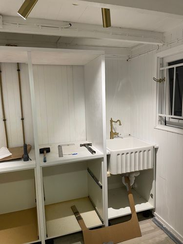

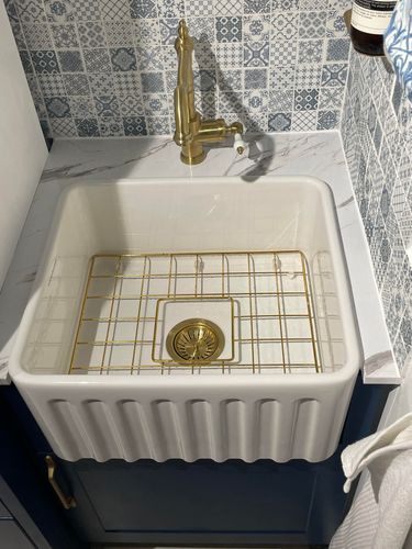

I installed a Belfast sink in my Utility/Laundry Room. All of the cabinets (and benchtop) were from the Kaboodle range, so installing a fireclay Belfast sink required some modifications to the cabinetry e.g. cutting down the cabinet door below the sink and extra reinforcing supports to take the significant weight of the sink.
Because the sink was handmade, I waited until I took delivery of it and I hand-traced a series of cardboard templates of the sink to transfer to the Kaboodle benchtop (you can just see one of the benchtop templates in the photo). I could then accurately cut out the outline of the sink with my jigsaw and was confident that my sink would fit perfectly.
If you're doing a drop-in sink, they usually come with a template and a set of instructions (I had to freestyle it because I wanted my sink to sit proud of the benchtop and cabinetry in the Victorian-era style) and there is usually a 'lip' on the sink of several millimetres, so you don't have to be ABSOLUTELY exactly perfect with your measuring - I had no margin for error (slightly stressful) and so I made sure to take my time before I pressed the buttons of my trusty jigsaw.

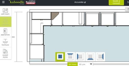

I created a digital folder of my own plans, photos and sketches (digital as well as hand-drawn) so I had a strong vision in my head of what I wanted. I made regular use of the Bunnings Kaboodle digital planning site - it was invaluable!

These are some photos of the finished room; my Utility room transformation post has a longer post of the steps of my whole project; very happy to answer any questions you might have, if you see anything that sparks your curiosity.

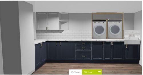

Hi @Jordon11,
I think it would be well worth the cost of a budget reno to remove the laundry tub and install a sink cabinet. A 600mm wall cabinet could go above it. You could then use the cutout section of the benchtop to make an insert for the sink to cover it. I've created a rendering for you below.
