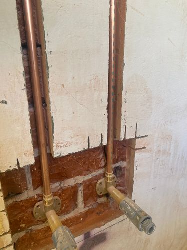

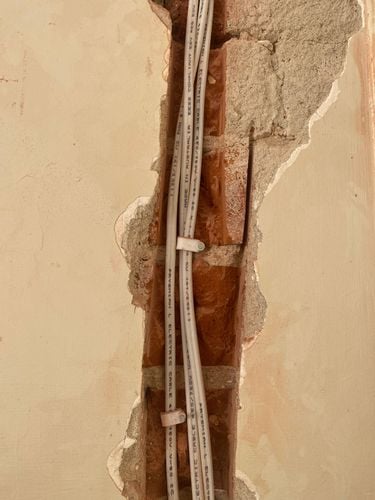

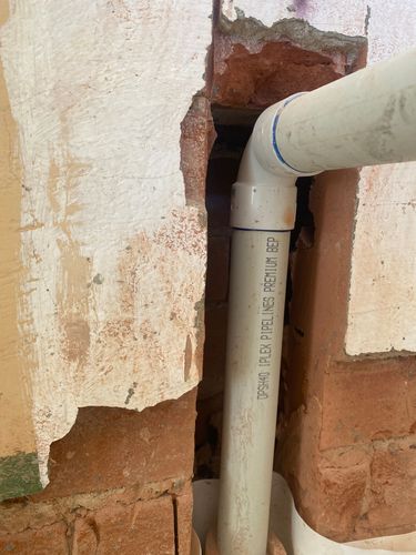

Hi - I’ve had new copper pipes, PVC drain pipe and electrical cables chased into the brick wall of my bathroom that I’m renovating. I can’t find a straight answer about whether it’s best to add a covering before rendering or rendering straight over the pipes/cables. I’ve read that cement (in the rendering mix) can be corrosive to certain materials. There is also a big space where the PVC drain pipe was added so it’ll be hard to add render without something filling the space.
I’ve added some photos below. Any advice would be greatly appreciated!

The main thing when cover in wires is to make sure it is pinned well flat agaisnt wall so the render depth isnt weakened. Ideally I would have wires in conduit in case of future access but it dosnt look like you have the depth for that in the brick check outs? I might be tempted to cut some trunking to protect wires and render a screw top and bottom into bricks should suffice IF possible. Or measure brick dimentions at the narrowest for the trunking of a smaller size.(Trunking Is rectangle box and clip on lid.) This also gives rendering a better protection too.
The issue I feel is any on moving the cables or pipes at the top or bottom is staring to weak render at those points if it is fixed directly in wall with no support I hope electricity at the ends come out into a gpo or something to allow some movement and cable managment.
The PVC pipe in the larger cavity I might see if it is possible to cover the pipe so the full cavity dosnt need to be filled fully. You want at least 30mm render on a solid base.
The old way was to pack around the pipe with newspaper to fill the void a new way might be expanding foam that hardens and can be shaped. If any others here have succeeded at that chime in please.
@Akanksha Yes it can but AS300 stipulates a few requirements that will need to be consulted with an Electrical Contractor if you are to comply, keep safe and not void your insurance.
You will also need maintain separation between services once again it is in AS300 and can be consulted with your Plumbing contractor and Electrician.

Reading @Jewelleryrescue and @CSParnell were saying I thought they had covered my line of thinking but then I was looking back over the photos and saw the power cables sitting in that chased section without being in conduit (solid or corrorgated) From memory they need to be mechanically protected and filling over with render is not part of that.
Admittidly I havnt read the current Australian Rules but id be hesitant to render over it.
Renderring over the copper water pipes I have in the back of my head as something about corrosive and long term effects on copper. but cant tag it down 😕 sorry
Id err on the side of caution and get a sparky and plumber to have a squiz.

Thanks @Jewelleryrescue @CSParnell @Dave-1 for all your responses. The plumbing and electrical work was all completed by professional plumbers/electricians. I originally planned to pay a renderer/plasterer to complete the work and he said that he just goes straight over them. Seemed odd to me! I will get in contact with my electrical and ask them to put something over the cabling to protect it.

It looks like you've received some helpful advice. At a minimum, it appears the cables should be run in conduit. Once that work has been rectified, you'll be free to render over the conduit. For the PVC pipe, you'll need to use a small trowel to pack mortar around the back of the pipe, fixing it in position. Once the mortar has set and the pipe is stabilised, you'll be free to render over it.
