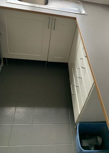

Thanks Mitchell-the video links are very helpful.I think as a shorter term solution I may go with painting them. Further down the line if we do vinyl would we need to remove the tiles on the bottom left of the wall?
Re: Easier to paint floor tiles or put vinyl down?
You wouldn't need to @smasshmurphy, but their removal would likely improve the new floor planks' look. Nothing wrong with leaving the tile border, though.

Would you paint the side tiles at the same time as the floor? I’ve done the prep and I’m ready to go but wondering how I avoid the roller scraping off the paint on the side tiles if I try paint both at the same time. Also what should it look like after the first coat?
Re: How to approach painting these tiles?
Hi @smasshmurphy,
It would be best to paint them all at the same time, and I'd recommend you use a roller that doesn't have a hard end cap that could scratch the adjacent surface. If you use the Dulux floor paint, they suggest a 4mm nap 100mm microfibre roller. These don't have hard end caps. They also advise cutting in with an angled sash cutter paintbrush. So, if you do find you are rubbing the paint off on the other tiles, you can switch to a brush.
Given the darker colour of your current tiles, after the first topcoat, you might still see some darker shadows. The second topcoat should cover those, but the instructions do call for at least two topcoats and a third might be required. You need to wait eight hours between topcoats. Remember, your first "coat" will be the primer, then two topcoats of paint. With the primer and two top coats, you should reach full coverage.
Thank you the small roller worked a treat!
