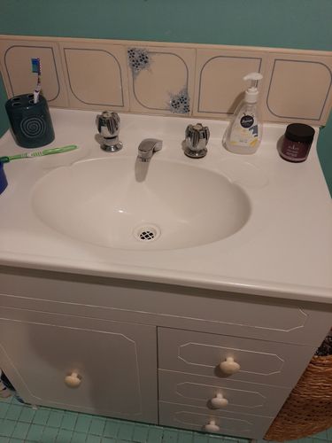

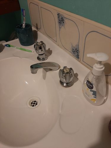

This may be a stupid question, but I'm just looking to replace these old basin taps, with lever type ones. I saw that basin taps to fit on the basin itself, are called "hob mounted taps".

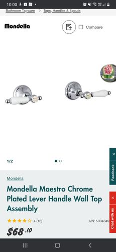

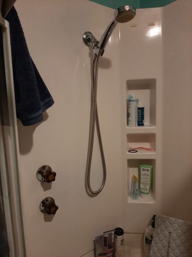

I'm looking to get these wall taps from bunnings for the shower and am wondering if another matching set would suit our basin set up as well?

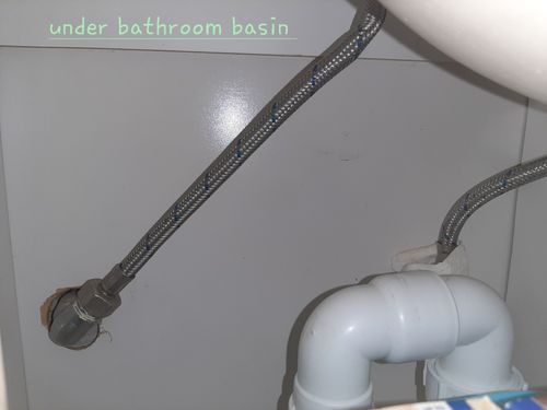

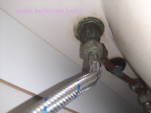

If you can upload an image of how the taps connect underneath the basin, I can confirm they will be compatible with the Mondella Maestro Chrome Plated Lever Handle Wall Top Assembly.
It is likely you will find Braided Connector Hoses, in which case you shouldn't have any issues.

Yes it looks like you said, with the braided hoses.

Unfortunately the Mondella Maestro Chrome Plated Lever Handles are only available in the wall version and not basin fix. Wall-style tap spindles are typically longer than basin top to allow for wall sheeting and tiles. There is a chance they would fit in your basin, but generally, you'll have fitment issues due to their length. There is some adjustability, but you'd need to attempt to fit them to find out when that will be enough to overcome their longer length.
