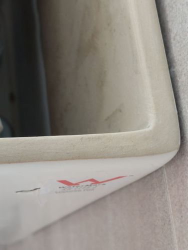

What's the best drill bit to drill a 5mm hole into the 15mm-thick side of a vitreous china WC (toilet tank) or toilet tank cover. Once drilled, I'll insert a flexible water tube through the hole to connect the water outlet inside the WC to the bidet using a T adapter (3-way valve.)

Welcome to the Bunnings Workshop community. Thank you for joining the discussion. If you've read the previous post it is better to use the 8mm Diamond tile drill bit as it will give you the correct size to pass the hose through. Let me tag @bazzyboy to make sure that they are aware of your question.
Please remember to wear safety gloves, goggles and a dust mask when drilling into a porcelain surface.

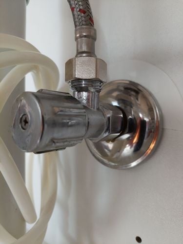

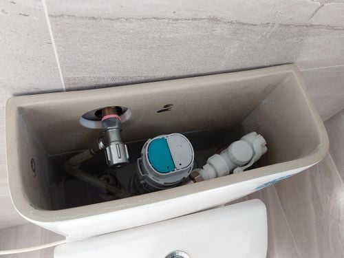

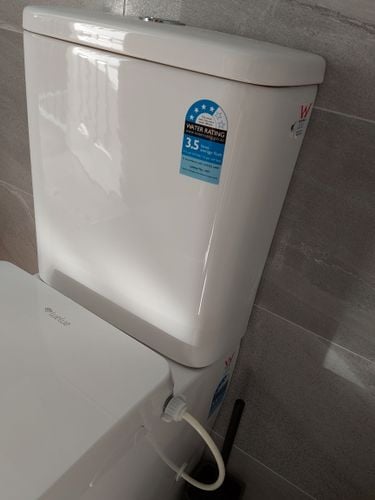

Thanks for your help Jacob. Please refer to attratched  photos, I have same toilet seat and want to install same setup.
bazzyboy
Re: Best drill bit for vitreous china (WC)?
Hi @arshmuglani - looking at the photos, you may not need to drill a hole in the WC as it already has the water outlet you use for the spray.
