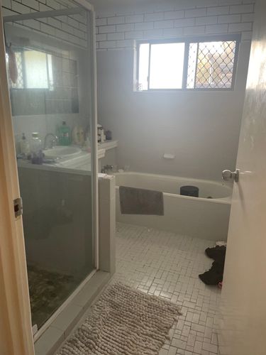

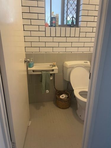

Hi- about to renovate our very old bathroom/ seperate toilet and want to also include a european laundry hopefully with a bit of storage space as well. We’d like to keep a bathtub if space allows, and keep plumbing where it is as much as possible. However we are a bit stuck for ideas on how to best design the space! The rooms are right next to each other.

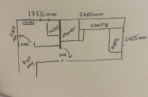

I'm sure if the rooms are right beside each other then we can figure something out to help you move forward.However, it's almost impossible without some kind of layout or floorplan with the dimensions. Also add positions of the doors. I assume you are prepared to pull down the adjoining wall (provided it isn't load bearing)?

Hi thanks so much for your reply! Here is a (very rough) drawing of how the space is now with the measurements. Hopefully that helps- appreciate your advice!

Hi - Thanks for your reply!!! Appreciate your advice! I have attached a very rough drawing of the layout and dimensions. Definitely happy to pull down the wall! Just having trouble figuring out exactly how to lay it all out and fit it in

Hi @Katemer
Thank you for posting that diagram, I will post my suggestion as soon as I finish sketching them.

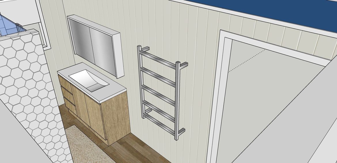

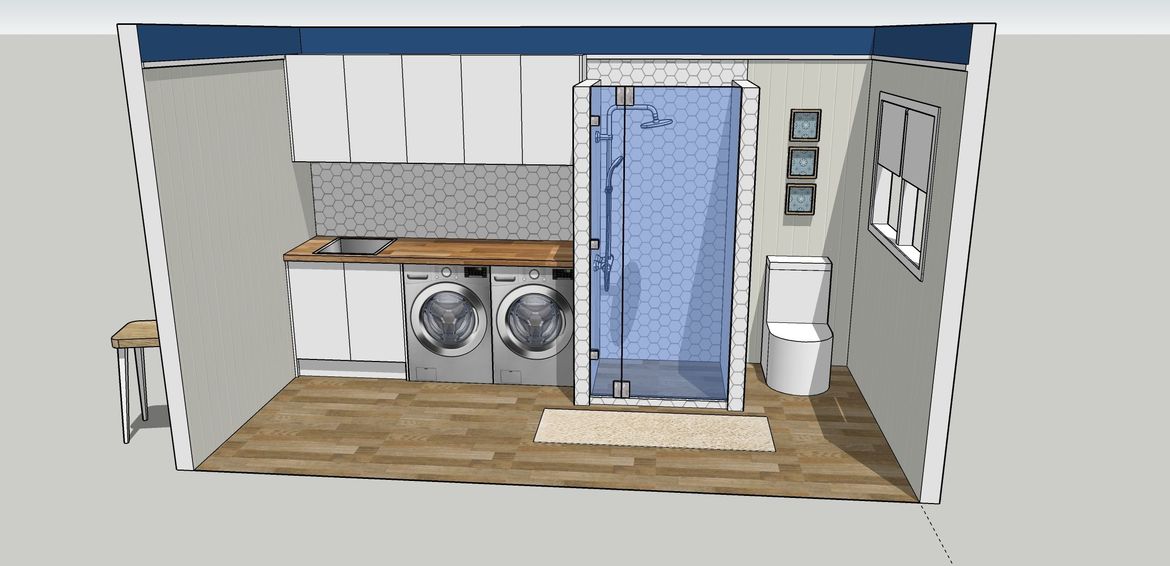

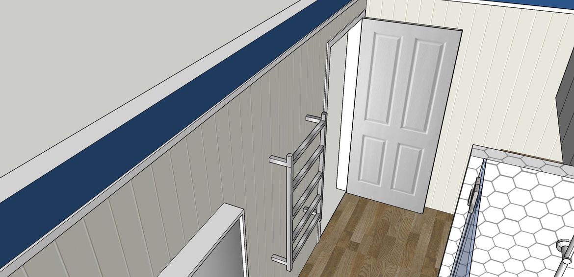

Hello @Katemer

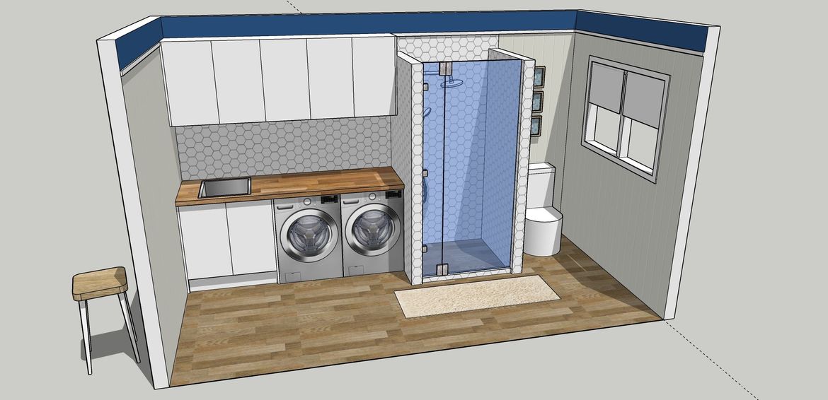

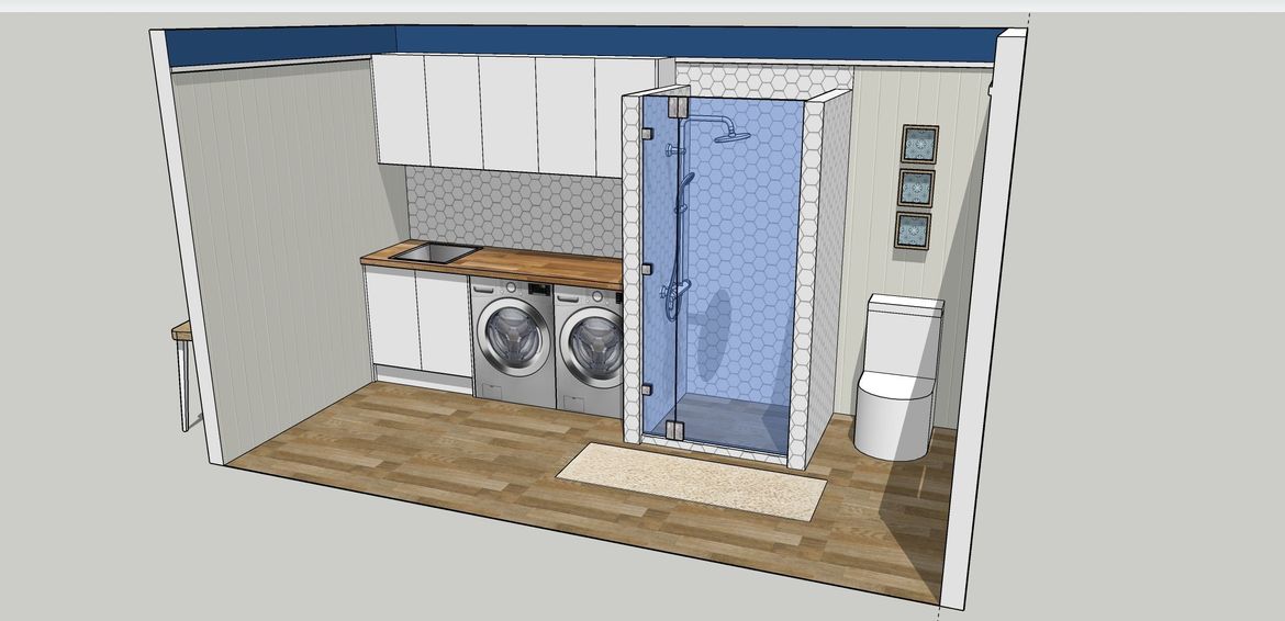

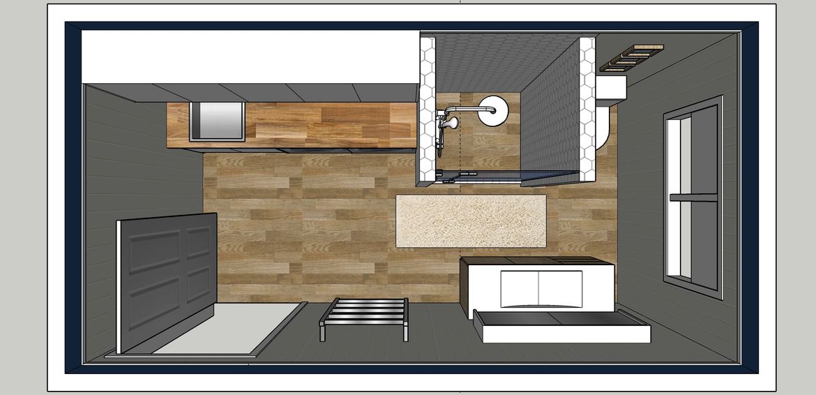

Thank you for your patience. Here is one idea that you might like, however, I had to take the bath out so that it won't look too crowded. Please have a look at the sketches and tell me what you think. If you wish to see it in another configuration, please let me know.
