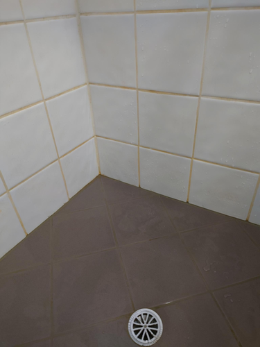

Re: After some great waterproofing products for special use
Impossible to tell from your photo but you could have multiple possible sources of water leaking - behind shower rose and/or tap penetrations, failed silicone at wall-to-wall or wall-to-floor junctions, failed grout, insufficient or failed waterproof membrane at your waste (a puddle flange should be installed under your waste).
Acrylic or polymarble bases are pretty leakproof if installed correctly. As a minimum, you should;
- Remove all tiles and probably plasterboard behind
- Remove floor tiles.
- Repair any damaged timber and flooring.
- Install new timber in walls to support new plasterboard.
- Check out timber studs to rebate the shower base as per manufacturer instructions.
- Install shower base.
- Install new plasterboard - tape and plaster joins, caulk only (no plaster compound) at wall-to-wall joins and at wall to shower base join.
- Waterproof walls with bond breaker at wall-to-wall joins
- Tile and grout.
- Reinstate shower screen.
There is no product that can produce a 10mm thick layer of waterproof gel...even if there was I can't think of a way that you'd be able to successfully terminate it to a waste without water running back underneath.

Hi @ivanptr,
I'd suggest you do a visual check of all grout joints between tiles whilst paying particular attention to where the walls meet the floor. Please let us know if you find any cracks and take some pictures. If the silicone/grout around the perimeter of the shower base is degraded, I'd recommend removing it and re-applying a bathroom silicone to those joints. After any repair work is dry, you can paint over the entire shower base and up the walls slightly with Shower Plug. Shower plug is good at covering hairline cracks, and the product will provide a layer that should assist with any water seeping out from between tiles. This is a band-aid solution that could help until you are ready to commit to further work.
The sika product you've linked to is for new installations. I can't see applying it over existing grout doing anything but causing a mess. I'd believe you'd be better off using a bathroom silicone.
Could you provide more detail on this carpet that is getting wet? Is it on the other side of a wall to the shower/taps/shower rose? If so, the first thing I'd be doing is cutting a section of plasterboard away directly above the wet carpet. You can then inspect the timber work, which will likely help you determine where the water is coming from. If there is water dripping/seeping down from above, it could be the taps/shower rose, and if it's only at floor level, seeping out of the shower pan area, then it's likely a failed membrane.

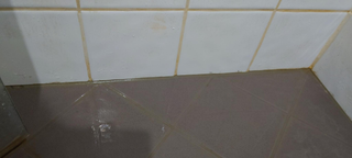

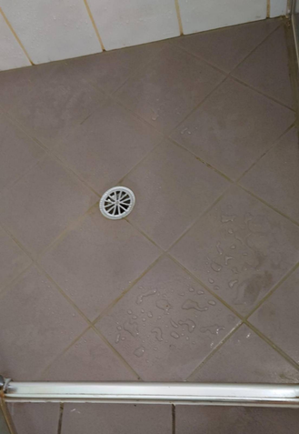

We have inspected visually and found no cracks -

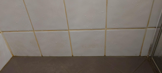

Floor to wall junction - couldnt find any crack, seems it is sealed with hard epoxy instead of silicone, as when we use fingers to poke at it, it feels solid and not elastic.
Wall to frame junction - degraded with some mould on it (frame on the right):
Floor Grout - seems okay with no crack visually
Grout under the steel frame - this is where we cant inspect, but the grout might be degraded with black mould due to high humidity in the bathroom.
Wastepipe - seems it is minorly clogged but not sure the "a puddle flange, the waterproof membrane" at the waste is failed

If you have water outside of your shower in your carpet then you have a leak somewhere. As previously mentioned it could be any number of issues and the remedy is to rip it all out and start again.
Installing a shower over your bath. I'm not sure what "planning" you need to do but you are spending a lot of time investigating and planning other solutions that could be used to address the issue.
Putting a shower over your bath at the opposite end to where the current plumbing is, taking down the wall, waterproofing, installing a screen etc. will be expensive. Plus, you will have a window effectively in your shower which will collect water in the frame.... it is nearly as bad an idea as having a live electrical appliance on a shelf above your bath.
If you can't see any visual cracks in the tile grout, then Showerplug will not resolve the issue. Having a saturated carpet means a significant amount of water is coming from somewhere. This could be a pipe leak, or the membrane has failed. This might be a silly question, but has anyone recently replaced taps or tap washers in the shower? I once encountered a similar situation where someone had forgotten to replace the spindle washer, and the carpet on the opposite side of the wall was getting saturated. A plumber, painter and builder had all missed/couldn't diagnose the issue. I went out to the property to assist the elderly customer because he was desperate. It took all of five minutes to work out where the water was coming from.
