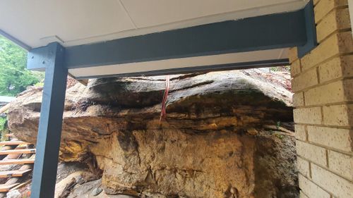

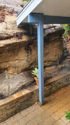

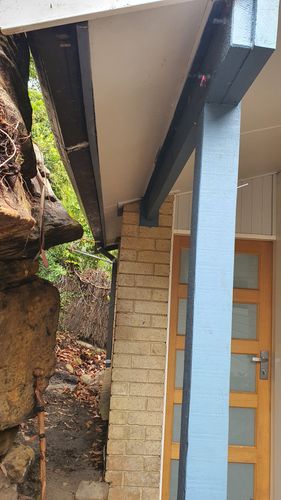

Can you upload some photos of where it meets the roof structure and how it is connected?
It is likely possible to prop the roof structure with Acrow Props, cut out the post and replace it like-for-like with a suitable post.

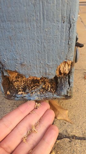

Hi @Samnet,
As I suspected, the pole is structural, meaning it will need to be replaced as a matter of urgency.
As the repair is of a structural nature and it is not going to be straightforward, I'd suggest contacting a carpenter for assistance on this one. They'll have the knowledge required to prop the roof structure, remove the post and replace it.

Hi @Samnet,
While the wall supports one end of the beam, the post still supports the other end of the beam which is supporting the roof.
If the post fails or slips from the post anchor, which is entirely possible considering the rot, then there is a potential that this roof will collapse.
My advice hasn't changed, the post will need to be replaced as soon as possible and it is best that you contact a carpenter for assistance.

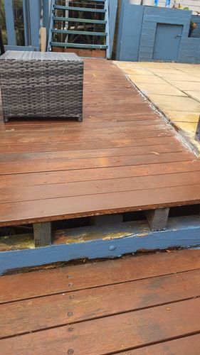

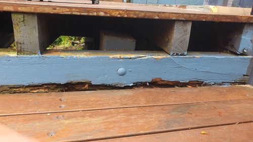

What about this part? Same issue under the deck. A horizontal timber under the deck
Thanks
Saman
Re: how to fix rotten pole
Hi @Samnet,
There is significant decay in that beam which is supporting the rest of the structure of the deck. I suggest you have it replaced as soon as possible.
It's hard to tell from the images, but if this is an elevated deck, you should isolate the area and prevent people from walking over it, as there is a real risk of collapse. Given the decay in this beam, the rest of the structure needs to be assessed by a professional as well.
