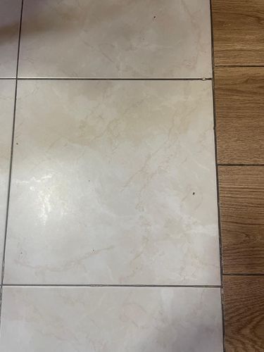

Hello @rmohlala
Thank you for sharing the photos of your tiled floor. I suggest going with Jacob's recommendation of using PC-11 56g White Epoxy Paste. It will be sufficient to repair the chips and cracks on your tiles surface. Please make sure to mix the epoxy paste very well in your hand so that it activates properly. Do not overfill the damaged sections but instead fill it to the same level as the tile.

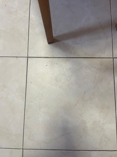

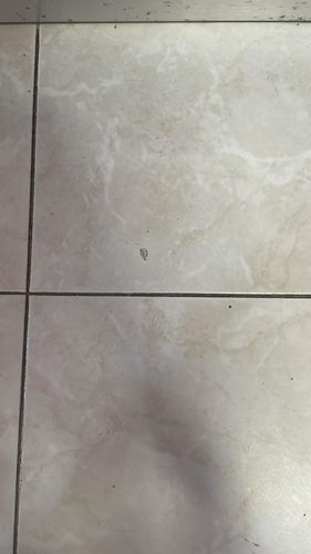

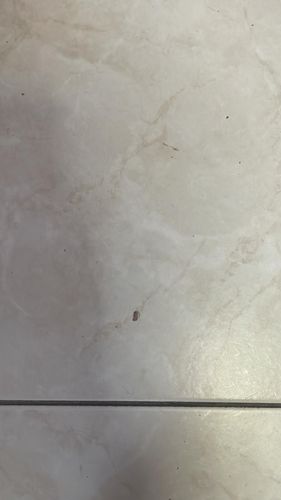

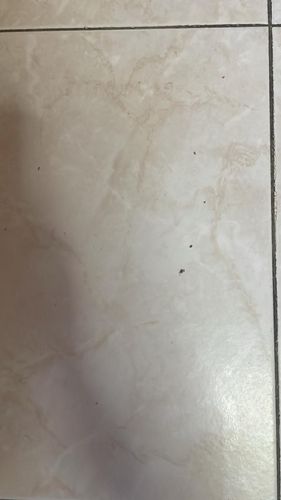

I posted pics to hopefully give you a better idea of what needs to be fixing.
Does the product you suggested require sanding after applying?
Thanks
