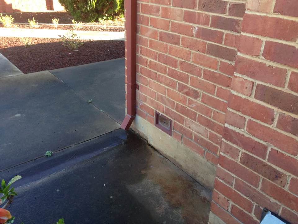

Got a feeling I found the problem.
Gutter
Drips miss the chanel.
Moss against the foundation.
Not the best piece of foundation work around the house.
Slope of the block would make it a high point.
Once you get past the topsoil you hit clay and the water table is high.

Great news @Brad, that should be an easy fix by either extending the down-pipe, or adding a deflecter, or even easier, siliconing the gap between the concrete path & the foundation.
Fingers crossed you have it beat.
By the way, the gas mains in our street is being upgraded, & the guys dug a hole 50cm deep near our foundation for the new pipework, which exposed a few interesting facts.
The soil had only traces of clay, & though moist, was still friable, in that it didn't form a dense clump when compressed, like heavy clay soils do.
The other thing of note, is that our foundations were virtually laid on the ground surface (not dug in), & I suspect that your visually tall foundations, may be the same.
