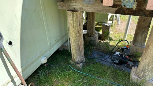

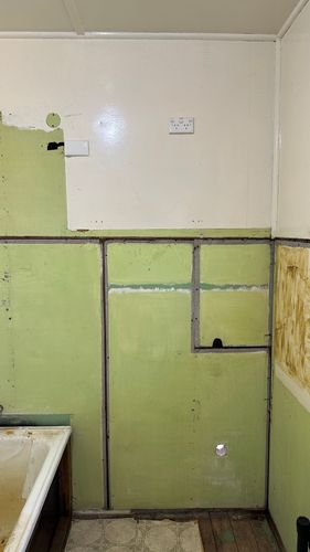

Hello @MitchellMc @Walter @EricL @Jewelleryrescue I need some dishwasher plumbing advice please...
Until the bathroom is installed, I would like to temporarily put a dishwasher in there. I have access to a power point, and a hole right through the wall which goes out to my ozito constant pressure pump. What plumbing connections do I need to buy to connect the dishwasher to the pump, and preferably with an extra outlet for the garden hose to stay connected to.
The dishwasher will be up against the wall, and on the external side the pump is `2m from the wall.

Just while looking at you pictures your constant pressure pump  (not now  into the future)  could use a 10Lto 20L pressure tank . which means it wont start pumping so often and prematurely fail. Talk later date  as they can be bought reconditioned cheaper than new. As water supply is important look to buy a spare constant pressure  pump. I dont know  how ozito  pump will cope?  I am normally supporter of  ozito.
Depending on your invisable dishwasher specification if  has a standard power plug and a water inlet hose  Do not forget its water outlet needs into drain.
This is a bit of a grey area whether its ok to run it as a tempary setup theoretically possible but probably not worth your while to try and do.
In a setup house hold the plumbing is allready done all you have to do connect inlet hose and outlet hose at pre plumbed positions.  Dish washer dies  just swap them over.

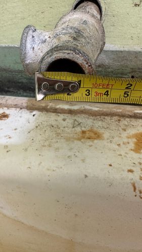

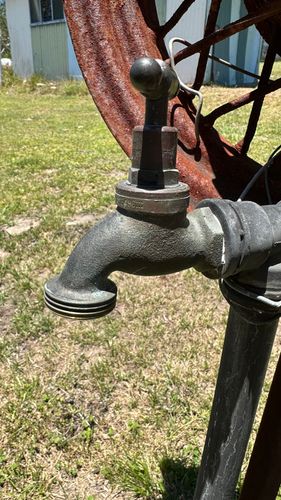

There is an old female tap connection running directly from the water tank, I could connect a tap with a suitable threaded male end if that's what the dishwasher could connect to. The water exiting the dishwasher would run straight into the old cast iron bathtub drain, so no worries there. Currently the ozito pressure pump does not connect to the house water, though I'd like to do that, especially if I can rig up a dishwasher. Pics below.
