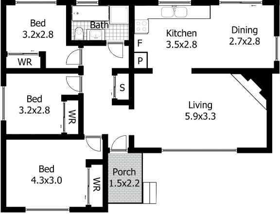

Hi Everyone,
I am new to this workshop group. I am just planning to buy an old house in Sydney and fully renovate it. Not sure if it is cost effective or it is better to buy the renovated house which is 150K to 200K more than the old house. Have anyone recently done full renovation by which I mean floor, wall paint (only inside), Kitchen and bathroom,3 bed room.
