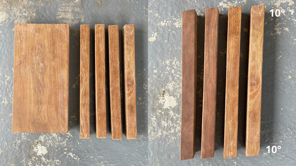

First we removed the tabletop pieces from the base and gave them a good sand. One piece was the perfect size for the top of the stool (measuring 430mm x 220mm x 45mm). Using a circular saw we then cut 4 legs out of another piece to the max width for the pocket hole jig (38mm) (measuring 420mm x 45mm x 38mm).
STEP 2
Using the mitre saw cut the 4 legs at matching 10° angles on both ends.

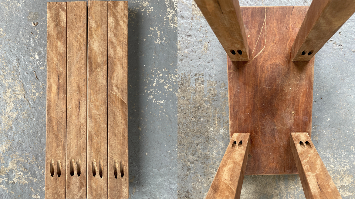

Drill two pocket holes into one end of each leg.
STEP 4
Mark out where you want the legs to attach to the top. I left 85mm of space from the ends and 10mm of space from the front and back edges.
Using wood glue and 2 ½ inch pocket hole screws attach the legs to the top.

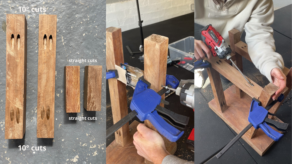

To make the long supports (for the front and back) we cut 2 additional pieces out of another tabletop piece the same as for the legs. Cut these at 10° opposite angles on both ends. Drill two pocket holes into both ends and attach to legs with 2 inch pocket hole screws.
STEP 6
To make the short supports (for the sides) cut two pieces to fit between the legs (these are straight cuts, no angles. You might even be able to use some offcuts). To attach to the legs, first drill pilot holes from the outside of the leg and then secure with 50mm wood screws and countersink. Fill screw holes with wood filler. Tip: You can make your own using sawdust from your project mixed with wood glue.
