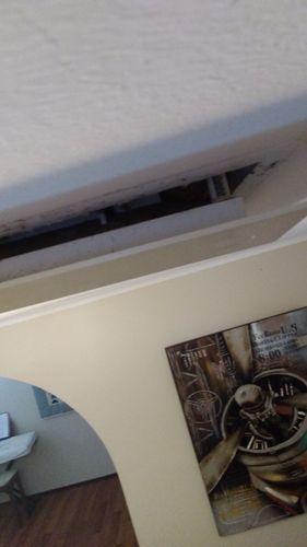

Some years ago we had our roof installation topped up and in the process, on a couple of the ceiling vents, the latches that hold the vents to the ceiling were broken causing the vents and ducting to protrude into our son's room.  The company sent their installer back out and he ended up resecuring the vents by strapping them to internal roof timbers.  The aircon is prob 30 years old and he said the original plastic latches are no longer manufactured.
Now, a few years later, latches securing other aircon vent have failed.
I was thinking of removing the screw that secures the broken latch, cutting it off and trying - say a gravity toggle or spring toggle.
I think might work ok on this vent.  There are a few other vents where only one of the latches has failed and gap between vent and ceiling is much smaller.
Any thoughts?

Using spring toggles sounds like an excellent idea. My only recommendation for your plan is to use washers so that the weight is spread and not concentrated on the head of the screw. I don't think gravity toggles will work on a vertical application. Just keep in mind the series of events for installation so that you don't accidentally drill bigger holes than necessary.
