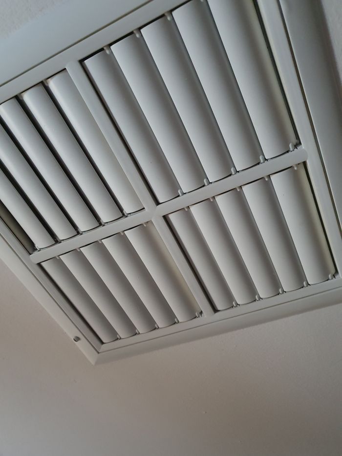

A very simply fix but proved to be effective. This had been on my mind for a very long time and I looked into chemical treatment and even replacing the vents, in the end I bought a can of gloss white spray paint and off I went. The hardest part was how to remove the vents from the ceiling, but once I worked that out it was incredibly quick and easy.
Materials
Gloss White spray paint
Tools
None. To remove the vents it was only a matter of pulling the vents down which released x3 holding clips.
Steps
Step 1
Removed vents from ceiling
Step 2
wiped vents down
Step 3
spray painted the vents
Step 4
re installed them into ceiling

No special cleaning, i just used a dustpan brush to clean the inside from dust, and the outside was completely clean, just discoloured. I only sprayed the outside.
I used the Fiddly Bits brand spray paint from Bunnings, gloss white. I did a light but even spray, and they look brand new. As the old plastic is just a solid plastic, I can't see how spray paint will cause any buckling/melting.

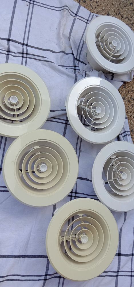

I got the first vent down today (more difficult than I had thought) and will try Dulux DuraMax when it gets warmer today.

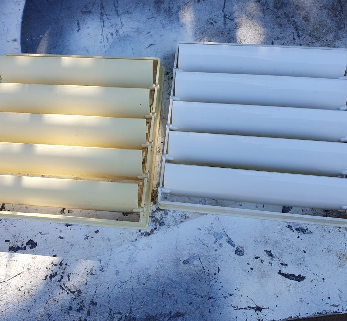

The paint is fantastic - highly recommend it.
I don't recommend with my style of vent to remove the entire frame.
With the next ones, I intend to spray paint the frame still in the ceiling.
But overall it does look better.
